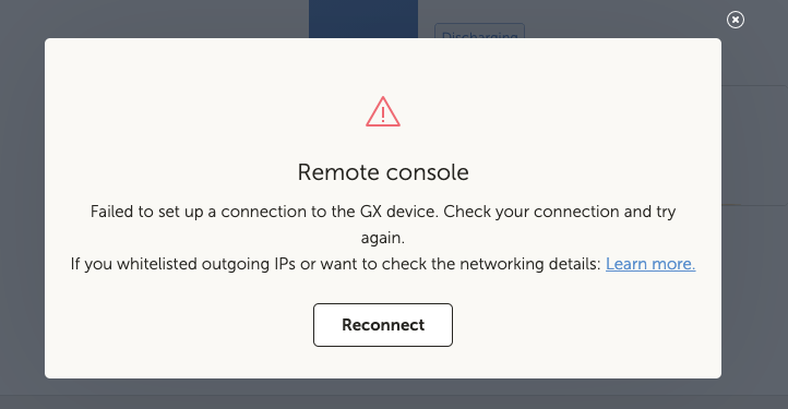

Read up a bit and found out about the http://venus.local/ method, which luckily works. Rebooted the VenusGX but still giving the same error in the VRM portal. I also logged out of the VRM portal and logged in again – same thing.
Is this something that “should” correct by itself, or is there something else I should do/try?
It is connected via Wifi, but I see the signal strength is about 60%. I have actually pulled through a LAN cable to the garage where the whole setup is, so might try to switch from Wifi to ethernet. Unfortunately, the garage seems to be a bit of a deadspot when it comes to Wifi – the alternative is to try and put another Ubiquiti access point there.

So anyway, I’m having trouble accessing my Remote Console (on Chrome), here’s the lowdown…
We have a Cerbo GX, installed on Friday 27/05/22. Firmware v2.86.
I’m on MacMini desktop OS X El Capitan. 10.11.6
My partner is on a MacBook pro.
We use the exact same IP.
She can access the Remote Console on her device, using Goggle Chrome, version 101.0.4951.64
I cannot. My Chrome version102.0.5005.61
Also, whilst using Chrome I cannot see the ‘Controls Icon’ to the right of the time displayed on Dashboard.
I can however access Remote Console on Firefox. No sweat.
Is anyone else having this problem? What shall I do should I want to use Chrome? (oh, and I have cleared out my Cache)

Nope, just checked, no change. This has been the situation since Saturday 28/05.
Not sure if it means something, for some of my reading up suggests it may, but on my ‘Device List’ page for the Gateway my “Remote on LAN” line is empty…
see if this does anything (adapted from here, after being pointed in the direction form here). I have no idea if this relates to the problem and do not know what unintended consequences might be from the workaround - so try at your own risk.
Type in chrome://version/?show-variations-cmd into the Chrome address bar.
Search for text: PrivateNetworkAccessSendPreflights/Disabled

VRM two-way comms does not affect this. If you have remote console on VRM enabled, and you set a password (or disabled it), it will work. On headless units (Venus GX, Cerbo without a display) the password check is by default disabled.
Also, I already checked his setup. I can access his remote console, as can the MAC computer next to him. Something specific is going on with this computer, or the firewall in the building.
Thank you all for your responses. I suspect it’s a setting on my computer somewhere, or a browser setting. I recently had my machine upgraded, more RAM, new SSD etc and since then almost all of the websites I always used are showing “Not Secure” warnings, plus some are now illegible…
These first three screen shots show the the Not Secure in that website bar, and a page that always pops up:
just curious, did you try the workaround I posted?
Chrome 102 comes with some security settings now enabled as default that were not the case with earlier versions - these changes could break some sites and the workaround will be my guess for where to look for something like vrm appearing broken.
