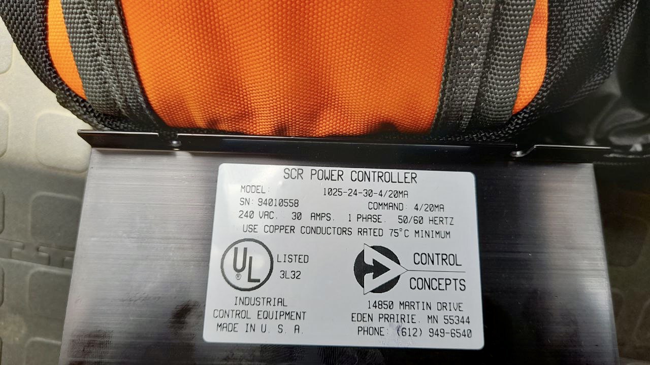

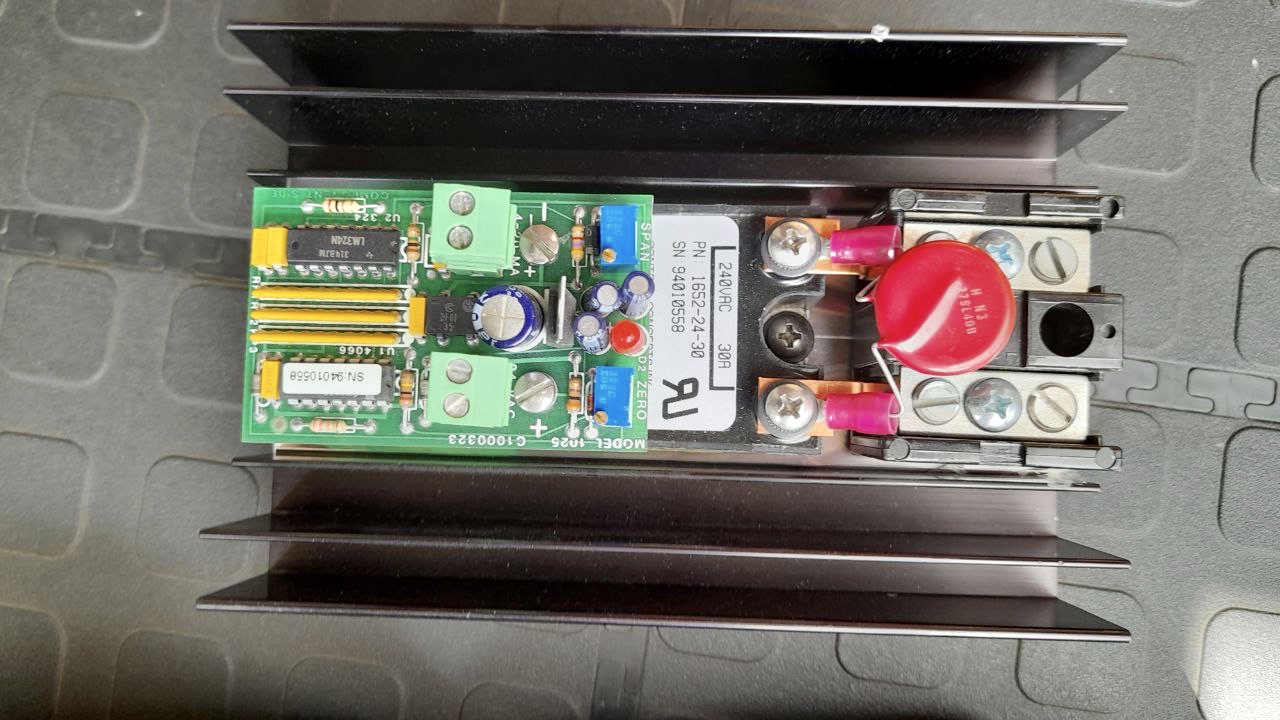

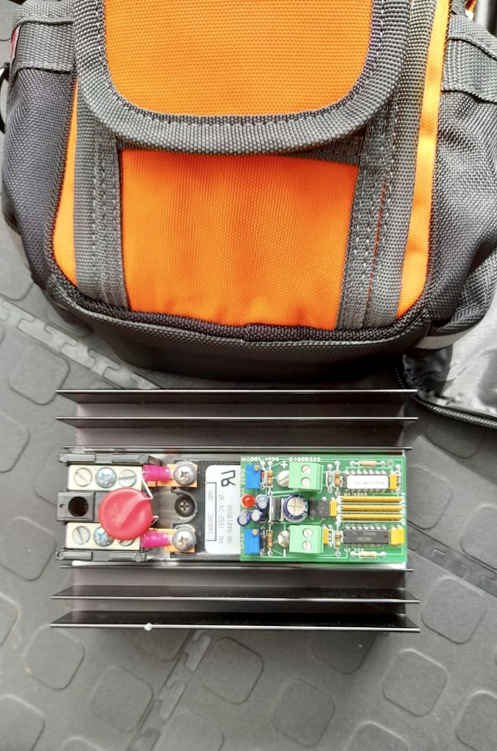

The new to me 2nd hand SCR controller arrived. Now to find the time to switch them w around and get this one working.
This one: Phase-angle
In phase-angle control, each SCR of the back-to-back pair is turned on for a variable portion of the half-cycle that it conducts. Power is regulated by advancing or delaying the point at which the SCR is turned ON within each half cycle. Light dimmers are an example of phase-angle control.
Phase-angle control provides a very fine resolution of power and is used to control fast responding loads such as tungsten-filament lamps or loads in which the resistance changes as a function of temperature. Phase-angle control is required if the load is transformer-coupled or inductive.
I have to ask where you got this “new to you” unit, ill wait to see how you find the results, might be a worthwhile upgrade for me to switch mine out to something similar to this.
Fleabay, imported. This one was a tad dear in comparison to the 20A zero cross units. They, zero cross type, work fine but cause a flicker in some of my lights. The langhaarhuisgediertes like that buggerall :crazy_face: :grinning_face_with_smiling_eyes:

Ok, the new SCR installed, works perfect, much kinder on the inverter too, as expected. No more flickering of some lights when it is switching, yay :grinning:
What are you using this for? And were you using a device to do the same thing previously?
If you scroll back to post 121… It controls my geyser’s power.

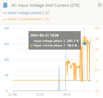

I see from VRM you have a lot of Grid Feed in happening… is this intentional…?
You could save some money by not doing this while you have great solar from the Fronius and your small 150/35…
Had my grid setpoint to high :man_facepalming:t2:

Just clicked on your VRM @Sarel.Wagner
Why are you feeding back so much today, do you suddenly like your municipality or do you still have a old disc meter which you are turning back to 0?
just rebalancing my use, I still dislike em just as much, so not planning on paying them any…
