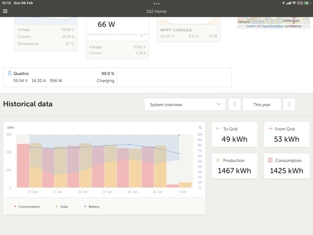

Main goal was to check how long I will last on storage power because I got 35kwh of storage and in the day the 10kw array will sit and idle along.

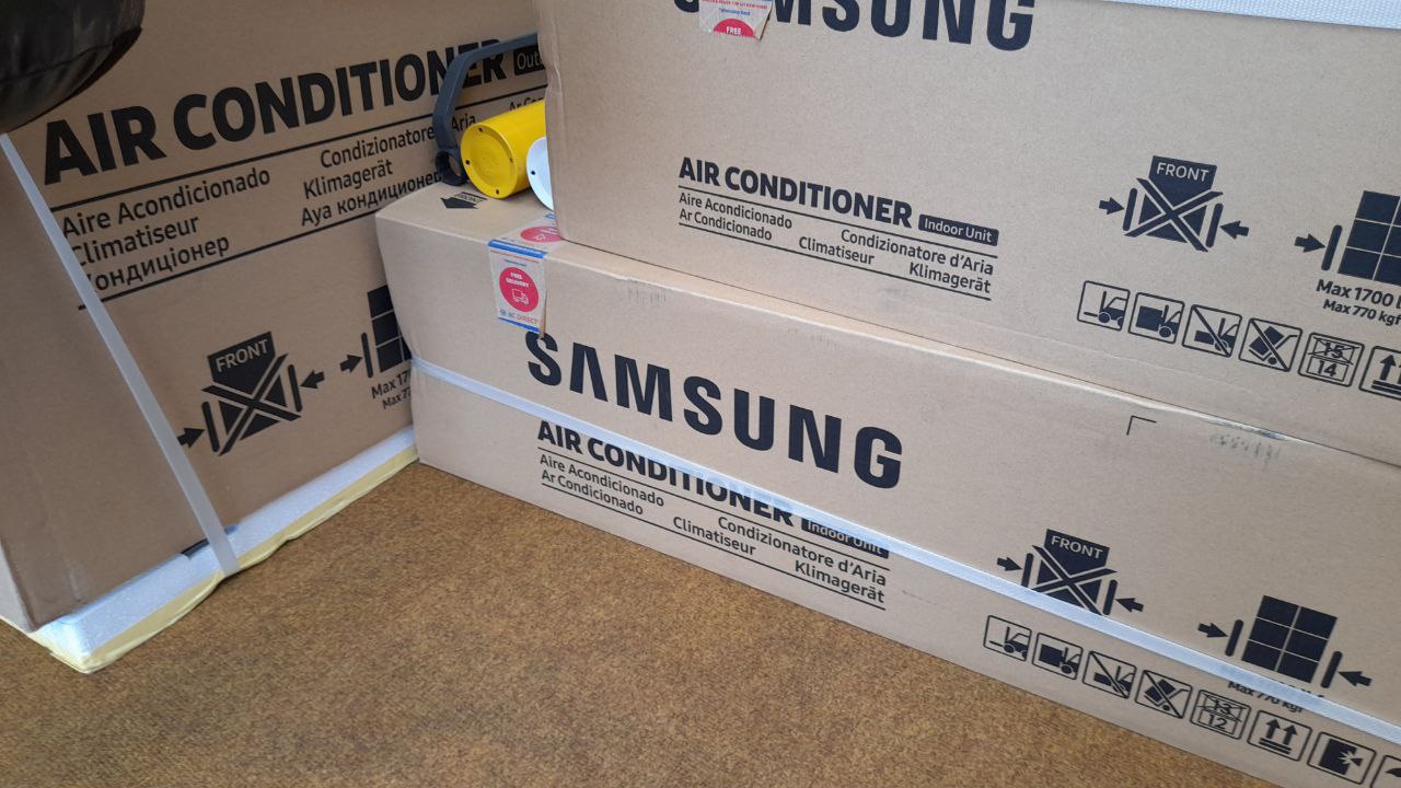

Samsung 12 and 24k Btu. 2 more will follow on wallet recovery :smirk:

This is what ESS did, with the bad weather and loadshedding, my SoC was set to 55% but it was effectively 65%, so it used about 4 units for one early morning 2 days ago. I am now feeding that back to balance again.

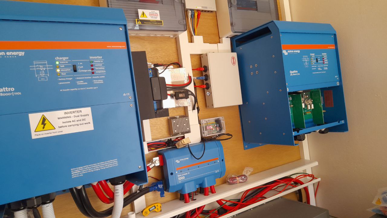

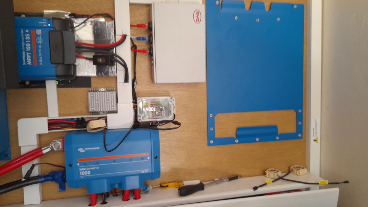

Adding to the install, second Quattro install started. Had to move some control wires from and to the Cerbo GX to make room. Also need to add another DB as the other AC DBs are full. Needed 2 more breakers on the output of both Quattros.
Still awaiting the DB and breakers to be shipped, delays and more delays.
Then tackle the wiring as I will have to rewire the original Quattro output to balance the wire lengths and route them via the new breakers. Then do the battery manual switches and the new battery cables. Then the programming can start….
Yeah, there’s a lot of rework needed when you add another unit, even if you planned for it :slight_smile:
And I did plan for it, still errors were made, oversights too, it was not perfect…. Will get by and have a solid system in the end.

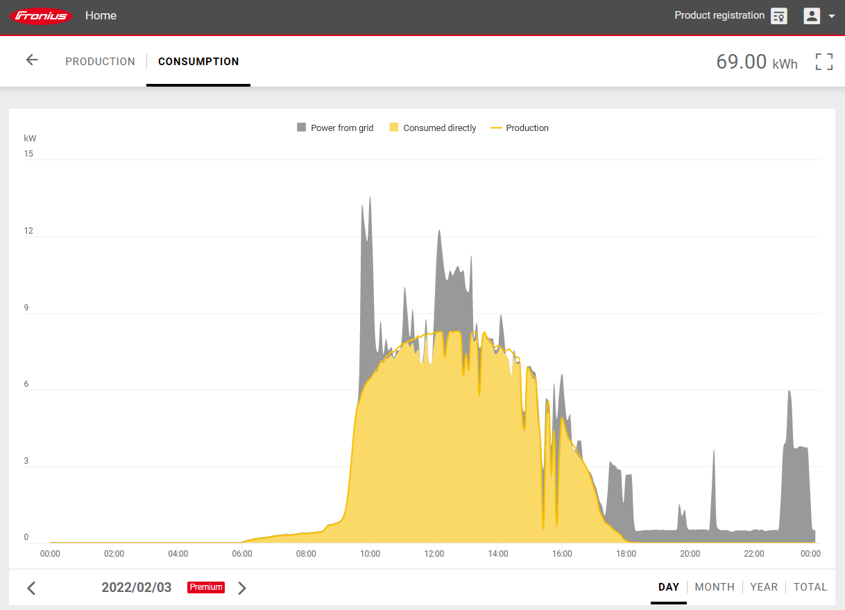

I am busy preparing my system to get my grid import to zero but without sacrificing anything… stove included…

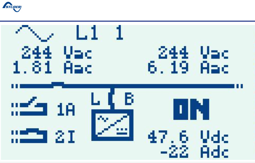

Below my Fronius and there after my 8KW Studer with the grid limited to 2A.
Below is a snapshot of now with 2 AC’s running…

Studer make very good hardware, but sadly they don’t have the updated NRS097-2017 certification, so technically you cannot get a CoC with them (unless you have a CoC for the Studer installation obtained before 2017, but then you cannot change anything on that installation). What is your question?
