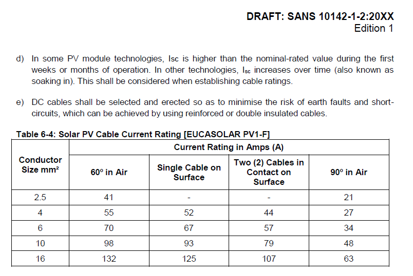

Your cables are seriously under used.
10mm2 can do 80A DC easy (SANS table show it as 98A at 60Deg)
Make a combiner box close to the panels. Then combine the strings in there using a DC fuse with 80A or lower and have just one set of cables to your MPPT.
In your case you already have all those cables, so you might as well use them.

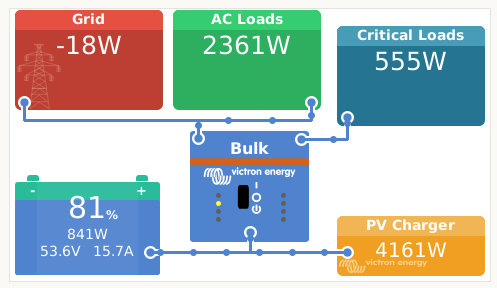

Haha! Yeah I didn’t even try to go there. But it is amazing how bad a few days of rain like this can make your PV system seem. At least I harvest ample rainwater… into a Jojo that has been full since the first rains…
Reminds me of when people tell me "I’m going off-grid and basta, I’ll show Eskom/ANC!
I then sit there silently smiling thinking “Mmm, another one who’s got no idea what shiite they are heading for.”
Since April this year, o man, Cpt has had week upon week of cold rainy spells. I’ve NEVER seen my winter production this low EVER.
Geez man, just last winter, and the one before, I saw I needed 500w more … what a joke … most days I watch and see 300w coming from 4.2kw AFTER I added the extra 500w!
