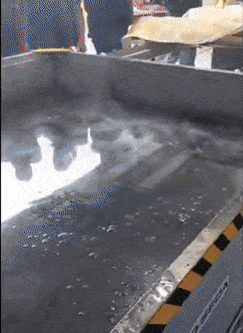

the video with almost immediate extinguishing of flames is impressive but they (source of the “water dunking table”) have another video where the flame is around for longer and probably more importantly quite some time after things look all calm the same/another cell ignites while under the water.
Lith_H20_Reignite
That tank is 920mm deep and 2700mm x1900mm (holding about 3300 litres liquid). If the main advantage of water immersion is cooling, how much cooling effect might you lose if you scale it down to fit in the house/garage?
So, while not far fetched I don’t see this sort of thing being practically viable in a residential setup - especially if wanting to make provision for an unattended thermal event.

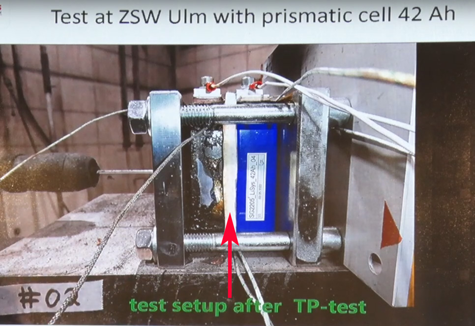

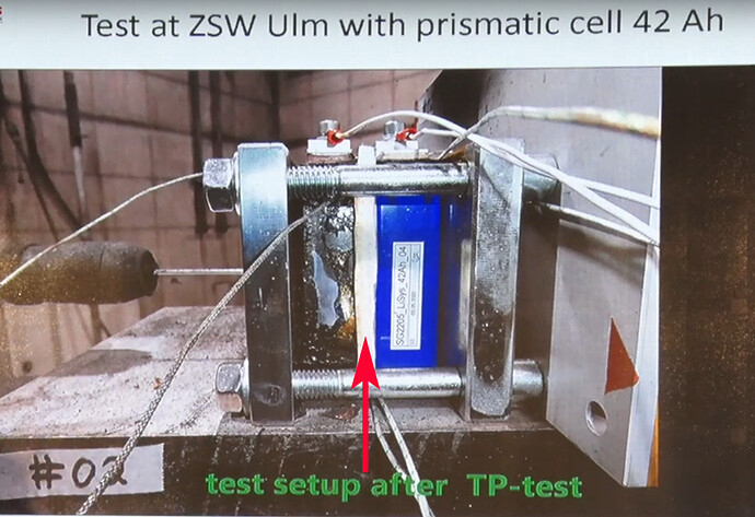

A less complicated and less messy option might be to try and reduce/eliminate thermal propagation between neighbouring cells through the use of insulating materials between cells. This seems to be a big part in EV battery safety.
Example of cell forced into thermal runaway while insulating material (red arrow) prevented spread to the other cell.
Vid showing silicone type material
Vid showing foam type material

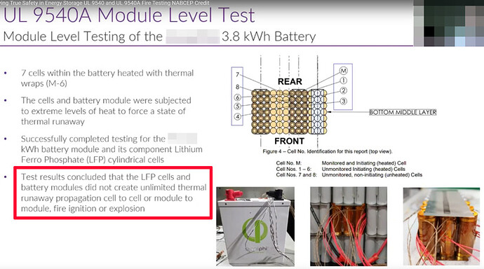

Not much help with DIY banks but another option is to look at batteries that are UL 9540 certified.
Example:

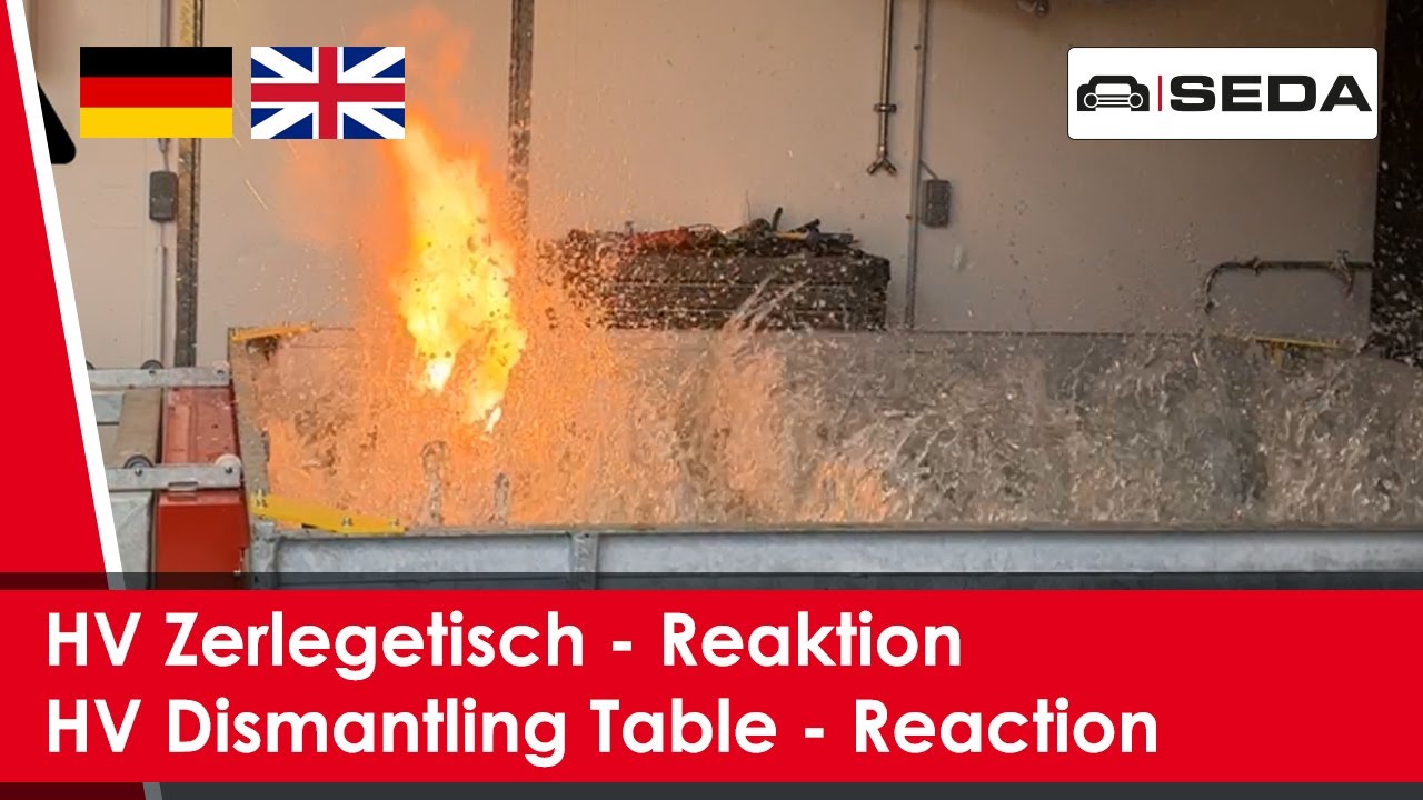

If anyone is intersted the original source of the “water dunking table” videos is a Austrian company that recycles vehicles - including EV’s. (video is time stamped to the “less impressive” result).

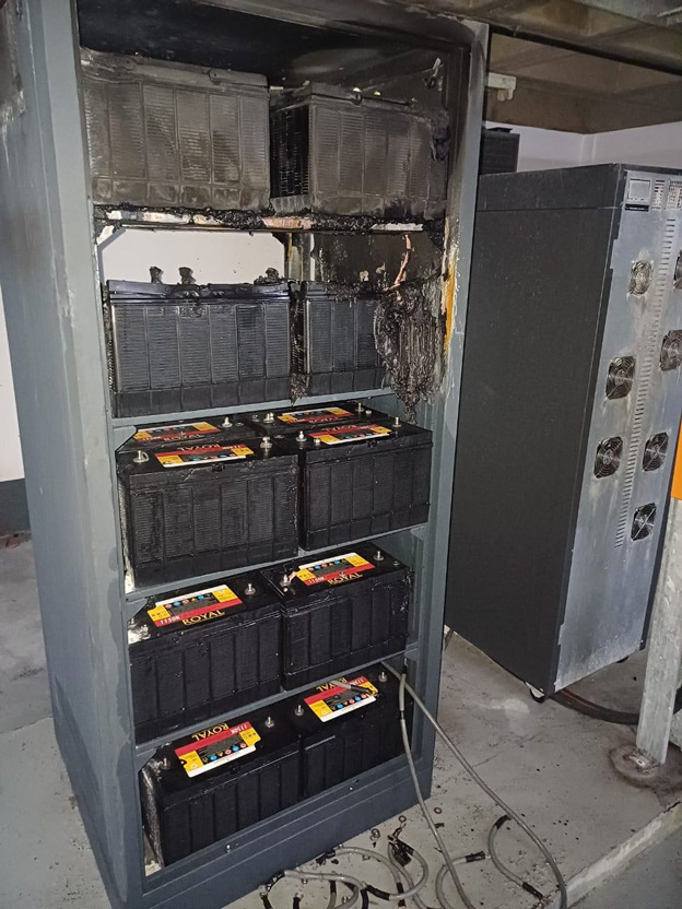

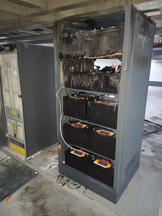

Going by the number of actual reported incidents in the South African media, the fire risk from batteries appears to not yet be overly concerning. Apart from the Table Mountain incident I found 3 incidents identified as battery related fires (maybe there are many more on the whatsapp groups etc?)

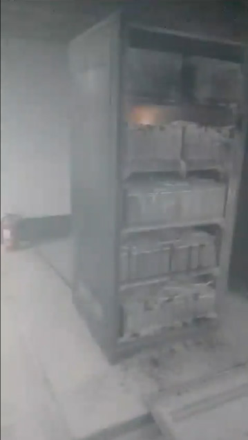

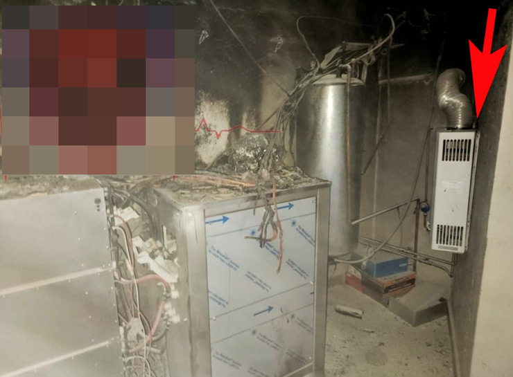

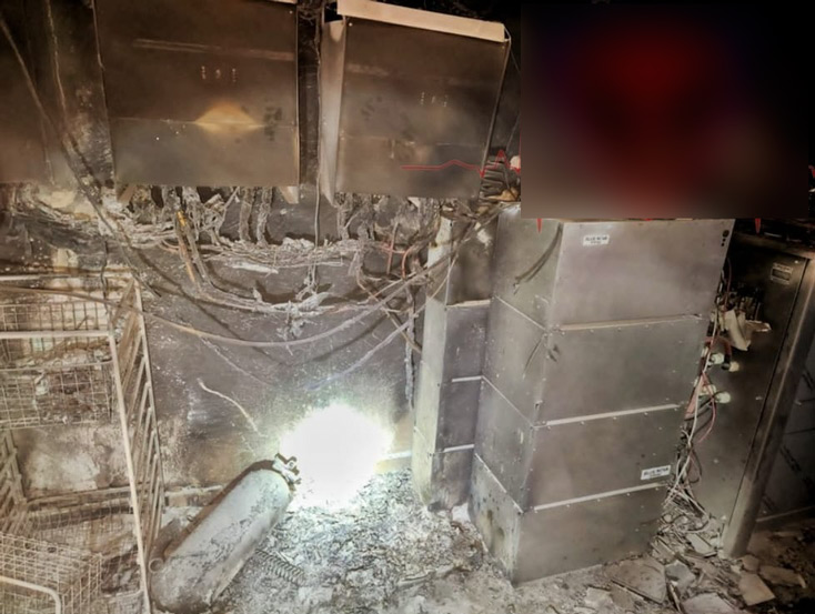

  1. the “Lithium battery” fire that wasn’t Lithium at all.
  • 23 November 2024
  • Steve Biko Academic Hospital
  • Gauteng Department of Health statement labeled this as
UPS lithium batteries back up system which had a leak and caught fire
  • Part of the semi sealed Lead Calcium battery bank for a UPS appears to have caught fire (as opposed to the more usual exploding of lead acid batteries?).
  • By the look of things, judicial use of powder type extinguishers got things mostly under control.

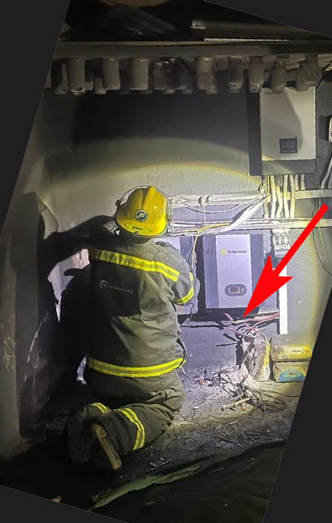

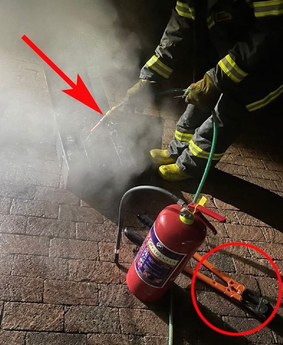

  1. the Lithium Battery fire that served as an advert for specialised (expensive) Lithium fire extinguishers
  • 27February 2024.
  • Residential battery system in Centurion.
  • Very little public info on the batteries but based on published charge voltages should be LiFePO4.
  • Big name security company responded to the fire and pointed out on their social media the use of their branded special fire extinguisher
  • Things that caught my eye: (1) Time/effort needed if decision is made to remove batteries from the structure/home/garage (needing to open up trunking, cut cables, etc). (2) note bolt cutter used to open up battery box. (3) note uncredited use of the home garden hose (unclear whether before or after the magic extinguisher). (4) wonder how much use the magic goo would be if the battery is still on the wall?

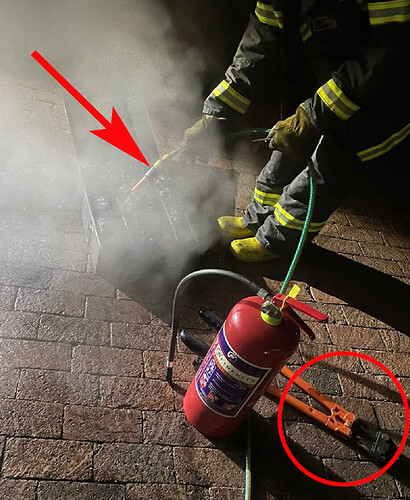

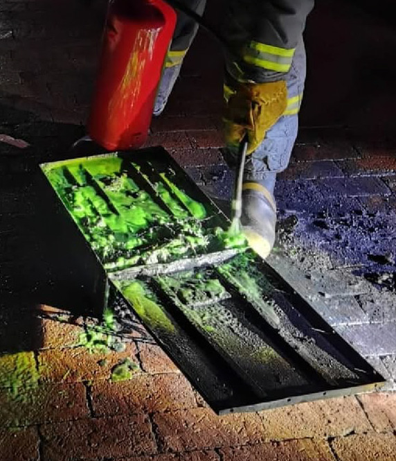

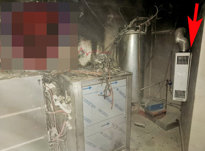

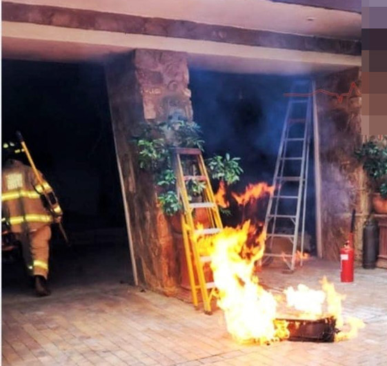

  1. Another one from north of the Juksei River…
  • 1 December 2024.
  • Residential system.
  • This one is interesting for 3 reasons.
    (1) the battery system in the photos appears to be one of the local batteries (as in, except the cells, being produced and assembled in South Africa vs white label branded imports).
    (2) the description of the event from the volunteer fire crew that attended the scene after an initial response from a fire department
a Lithium battery reignited due to a thermal runaway some time after Firefighters extinguished the fire.
*emphasis my own
(3) the apparent open flames from what I assume to be a/the battery when removed from the garage.
maybe 4, wonder about the wisdom of having a gas geyser in the same space as a fairly big battery system (pilot light meets venting battery gas…).
This last incident apparently also involved an exploding gas cylinder. Sequence of events are not clear, although the official statement from Emergency services stated
two lithium iron batteries had burst causing the fire in the garage…heat generated blew up a gas cylinder.
The reigniting, open flames and size of flaming object make me wonder if perhaps there might also have been something like an eBike battery in the garage and that it was actually not the home storage battery that was on fire?
