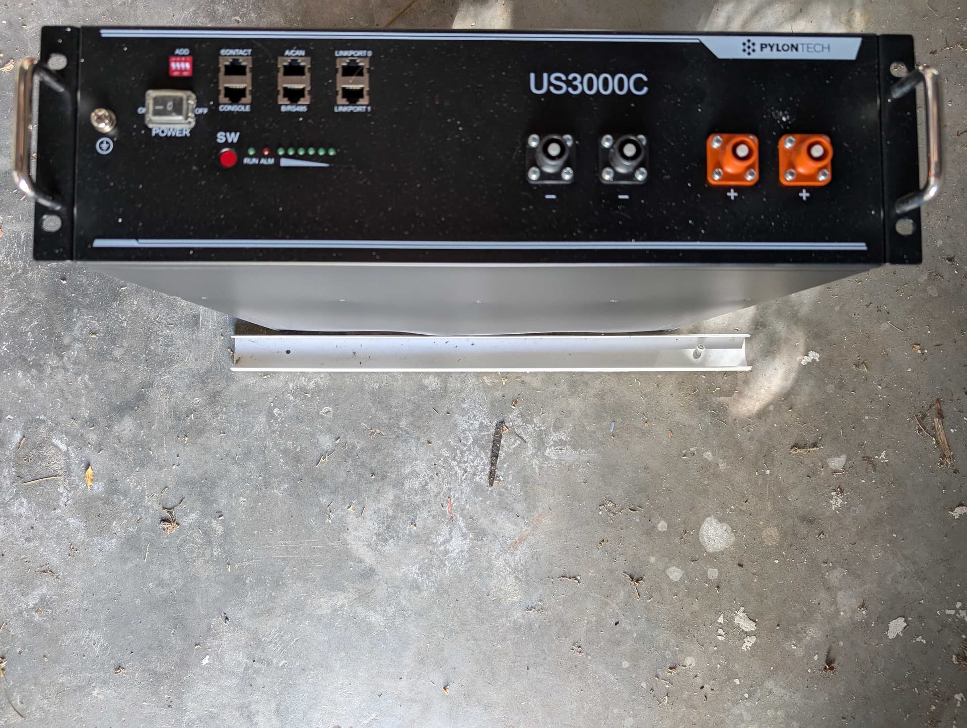

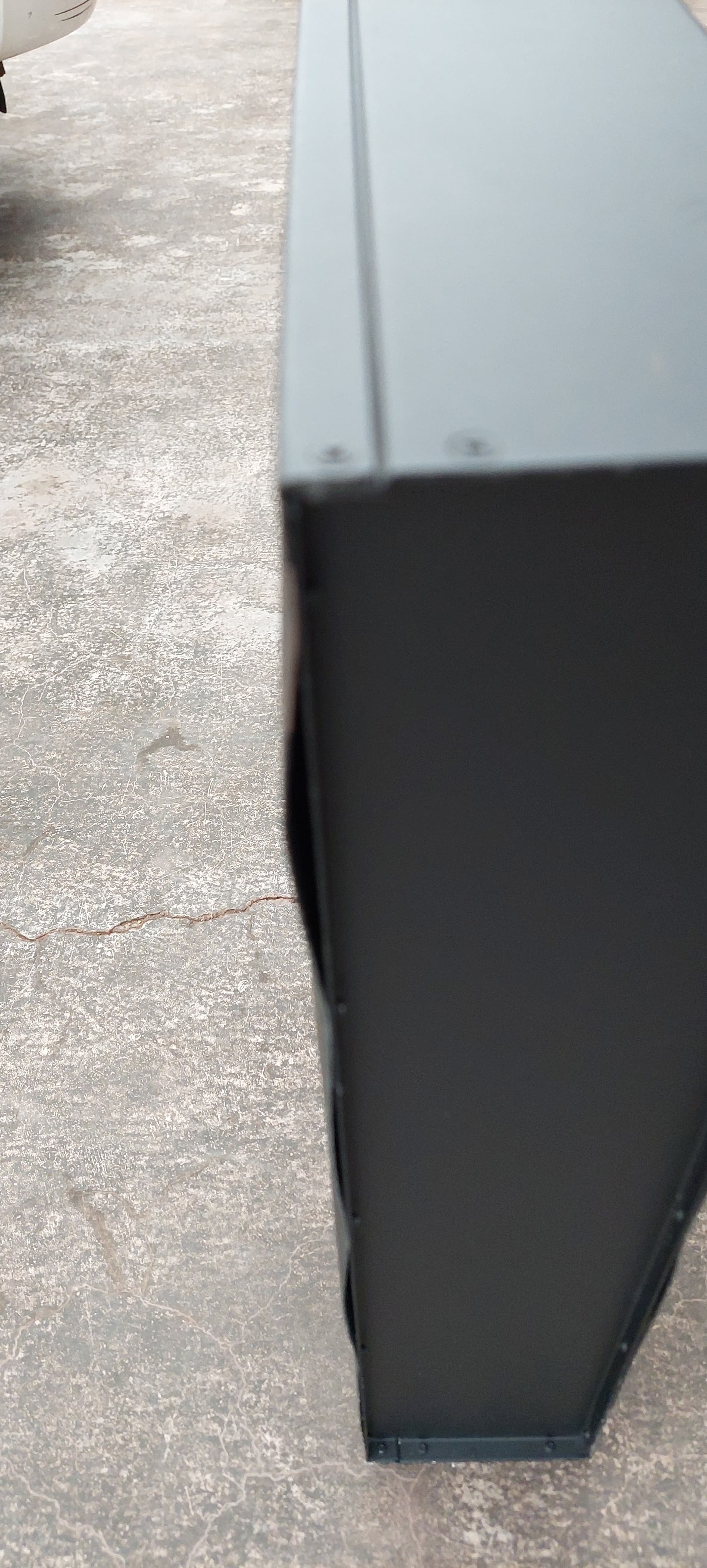

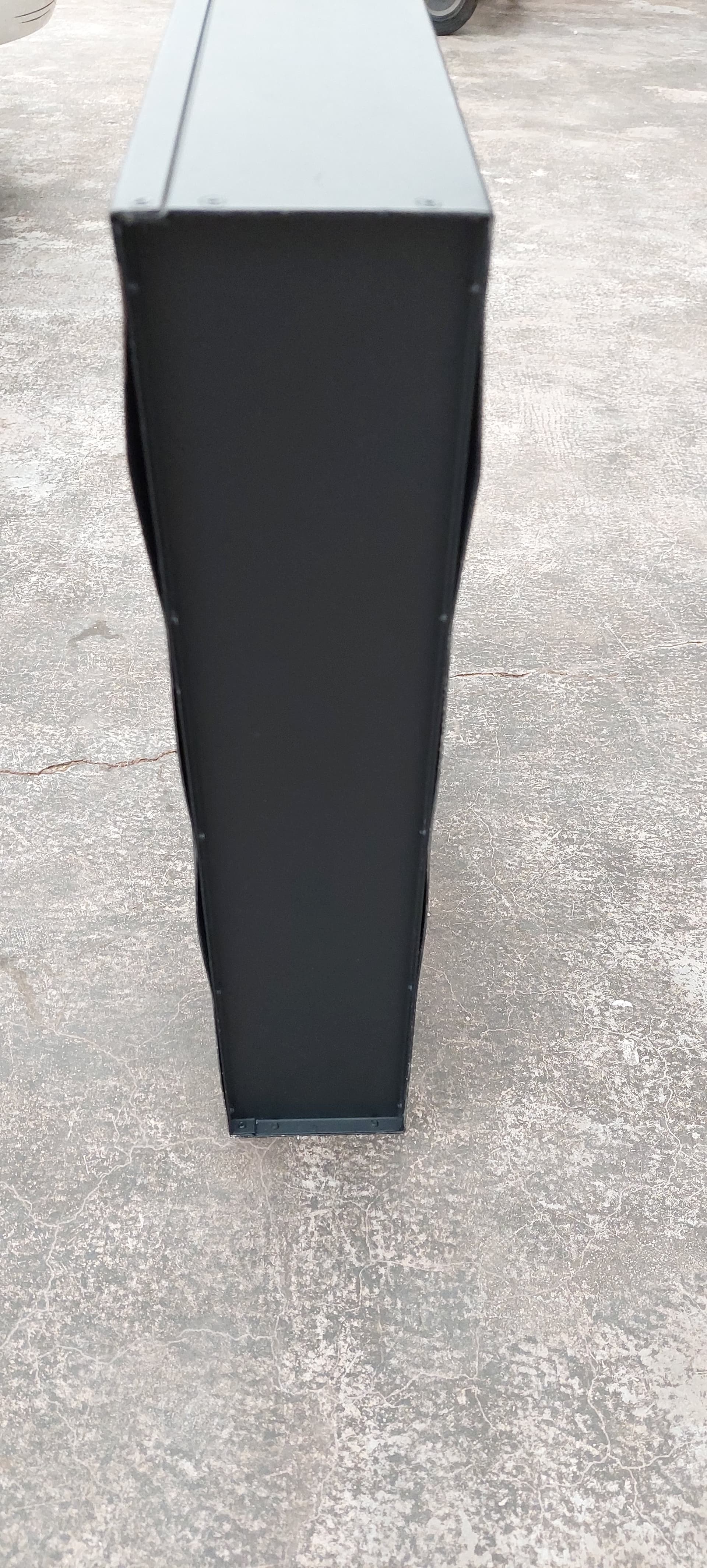

Anyways, walked past the battery yesterday only to see this:
Like, I didn’t even have to open it to know, something seriously wrong here.
Removed it from the garage attached to the house to another freestanding building, until it gets collected for the RMA process.
Battery was purchased in May 2021. So not even 4 years old. Cycled often as things go. The other one ordered at the same time is still going strong.

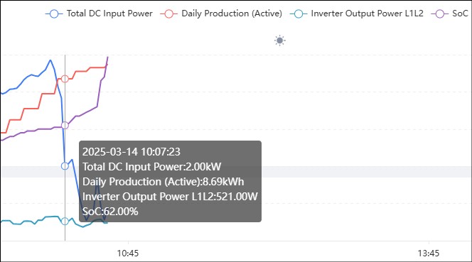

My battery bank is now going from 60% SOC to 100% SOC within 30 minutes, with minimal solar input :grimacing:
