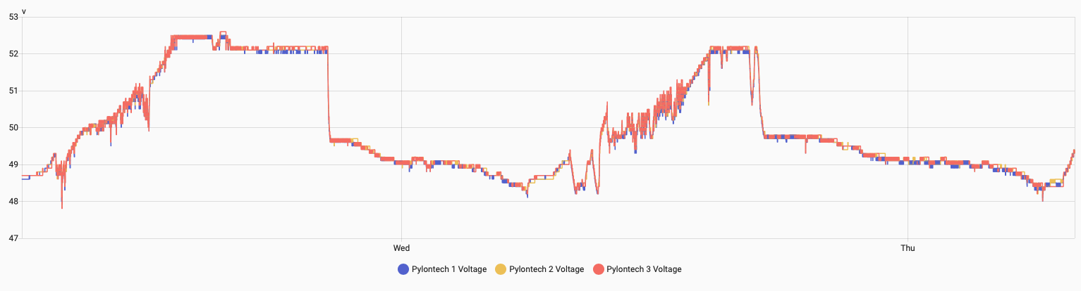

#2 and #3 are from the original Pylontech US3000B that I had.
Average voltage wise they seem to be more or less the same:

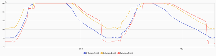

But for everything else they’re very misaligned with one another. No idea why #1 (the newer battery) behaves differently in SOC (I’m assuming it is because it is a newer battery and thus a different algorithm?). But #3 tends to drop in SOC incredibly fast when it reaches a certain point, which was definitely not the case a year ago.

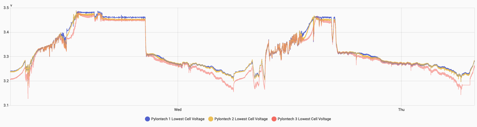

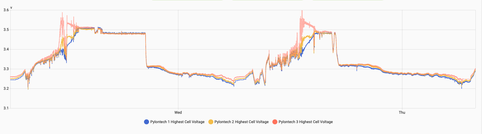

And looking at highest cell voltages and lowest cell voltages I have some concerns too:
Any thoughts?
I should probably disconnect the whole lot this weekend and look for swollen cases…
