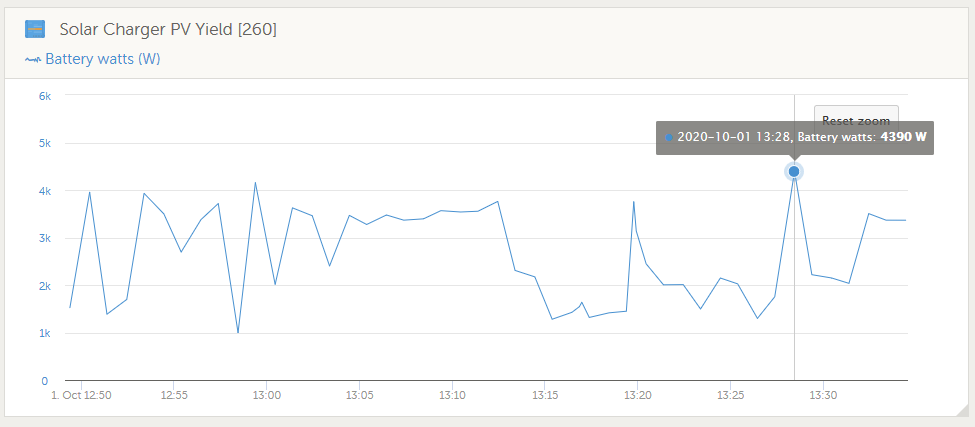

Have 10 x 350 Canadian Kumax panels = 3.5kw.
I missed the 4440w spike, but this one got recorded … on a cool cloudy day in Cape Town.

Yes, I have seen that quite a lot. On a partially cloudy day, the spike just after a cloud has moved over can be quite a lot higher than the peak on a sunny day. I guess it is because the panels have cooled down, and temperature makes a big difference.
I’ve recorded up to 4.5kW on my 3.8kW array. I understand it is called the “cloud edge” effect. Basically when the sun peaks out behind a cloud it magnifies it more. Something like that. Might be way off here.
Just puts into perspective why one does not want to run on the brink of the max volts the MPPT can handle.
You are so right. Temp makes a HUGE difference.
On hot days 3.2 - 3.3kw is easily generated.
But on cool days this is as easy on average for this 3.5kw array.
What is so nice in that picture, it is nearly 2pm, cloudy and cool in Cpt, geysers are heating and house loads loads are powered and batts are going to be full soon for evening use.
Solar is good. Life is good.

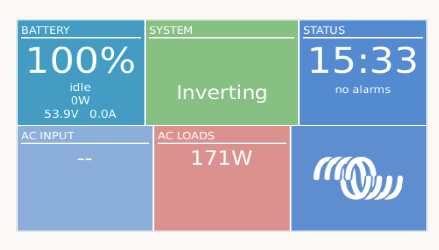

added the other screen so you can see how desolate it is without a grid connection, and without a victron mppt to read the solar input
I think you need to get a Victron MPPT just so that you can have that little block. It is so amazing.
One of these?
…I have one, just didn’t install it yet.

Next you’ll be telling me I need to get a grid connection so I can fill in my red box
I think you need a grid connection now
And some fuel tank levels and a generator. Makes me wonder… What does an entirely full interface look like… Anyone know?
