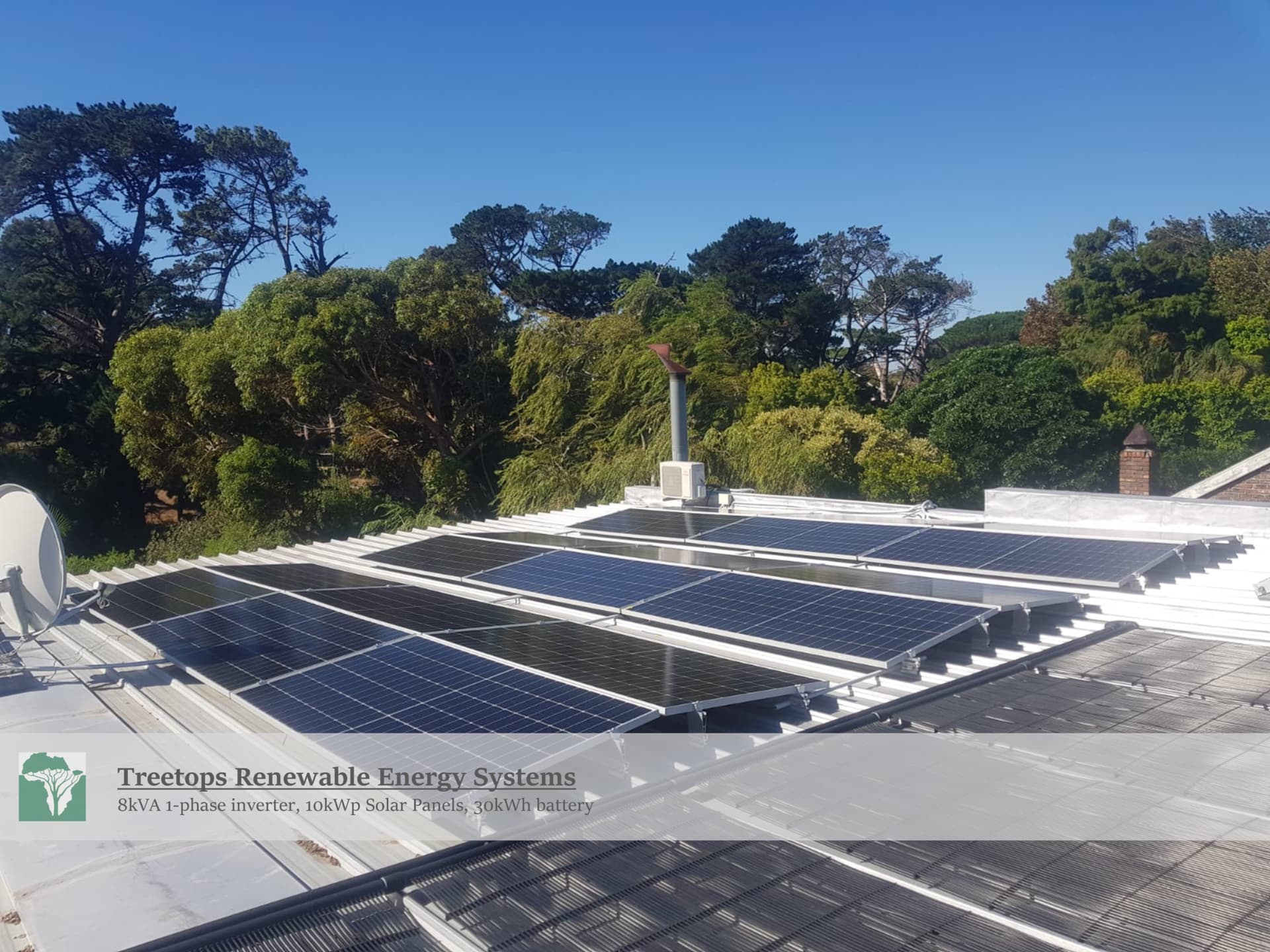

If you have a flat roof but space is limited there is some trade-off. You put angles on panes you need more space between them (meaning less panels). Or do you just do this sort of thing maxing out the panels as much as you can.

OK, so more panels flat, or fewer at an angle?
The best is to angle them properly North.
If all else fails, go flat, just add more panels to cater for the losses.

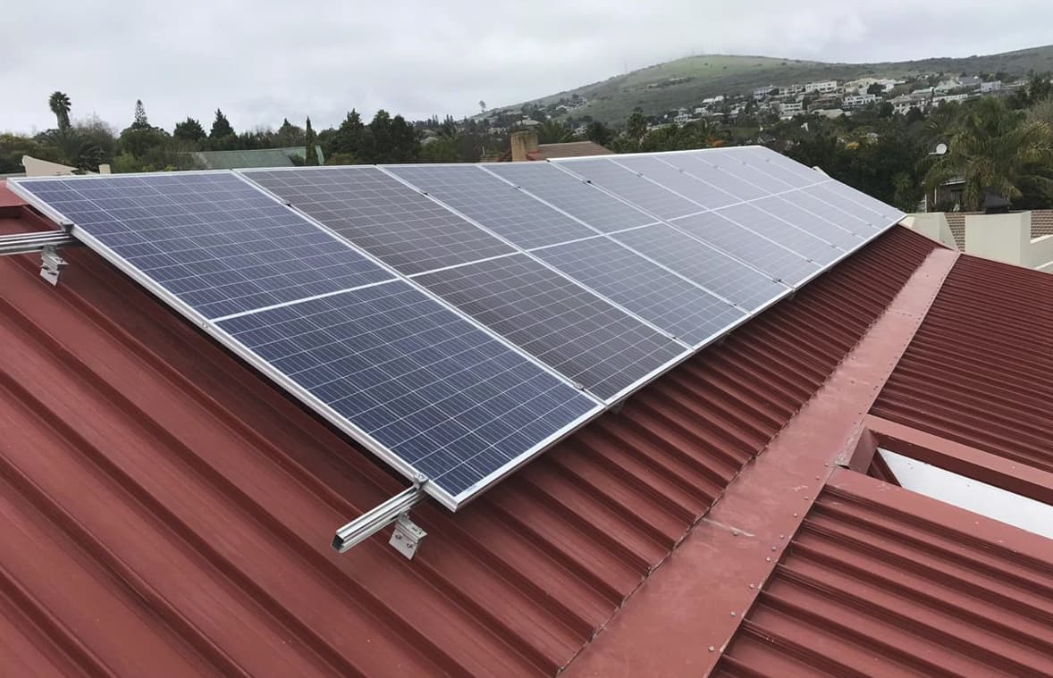

Our roof is North North West … the angle is what the angle is … early mornings in winter, blah blah blah … but we get sun till late, at least, ā€œlateā€ till the sun goes down over Plattekloof hill.

More panels flat.

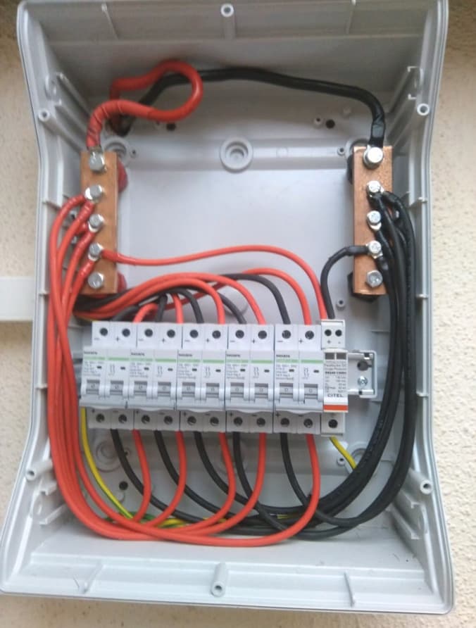

99% of the combining on a roof that we had to go fix, were crimped and had no protection. Having more than 2 strings combined like this is a recipe for disaster. If you want to avoid fires, don’t do it. For future fault finding, also don’t do it. For replacing a Mppt with a higher voltage Mppt in the future, don’t do it. As far as you can stay away from it, don’t complicate your life. Have everything on eye level and you can isolate, test and even rearrange strings without getting on the roof.
I know you feel there is nothing wrong with it, but out of a installers point of view and for all practical reasons, rather don’t do it.
You kinda left out the second half of my point, which is that it has to be formally, properly, crimped, surge protected, breakers, fuses, etc in a water proof combiner box on the roof. That is the only way you can do it in a way that there is ā€œnothing wrong with itā€. Just to be clear.
I absolutely hate those Y-joiners, and inline MC-4 fuses are from the devil as far as I am concerned. IT incentivises and legitimises precisely the thing you have to go and fix all the time :slight_smile:
Edit: I edited my post above to make it clearer.
Man, I’m so chuffed when we, @Rautenk and I, came up with this idea way back.
100% in line with this advice…
So easy to test each string. So what it was a few more meters of wire … the end result for years to come … Priceless.
Very neat. I want to do the same.
