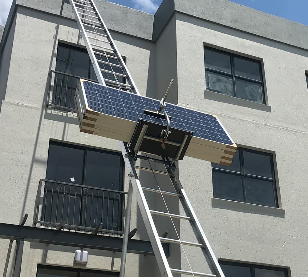

But there are also these kinds of things:
Although, you do need a rather good and properly long ladder for that to work. And washing the panels becomes another chore.
If you can get away with them at a lower level… absolutely do that.
Now that’s quite clever, because MC4’s are already waterproof!

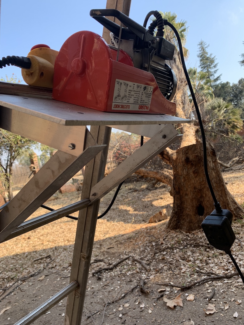

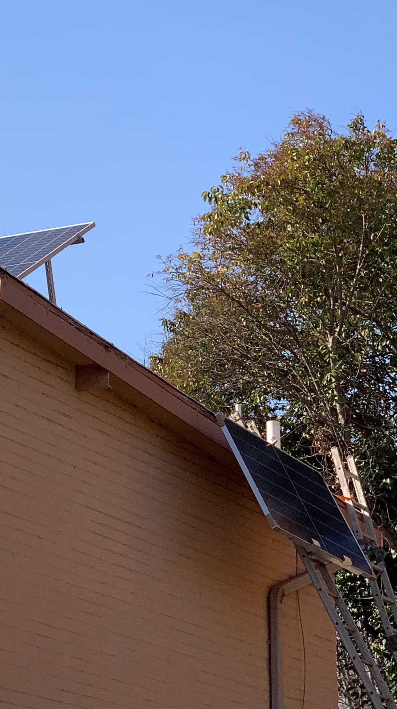

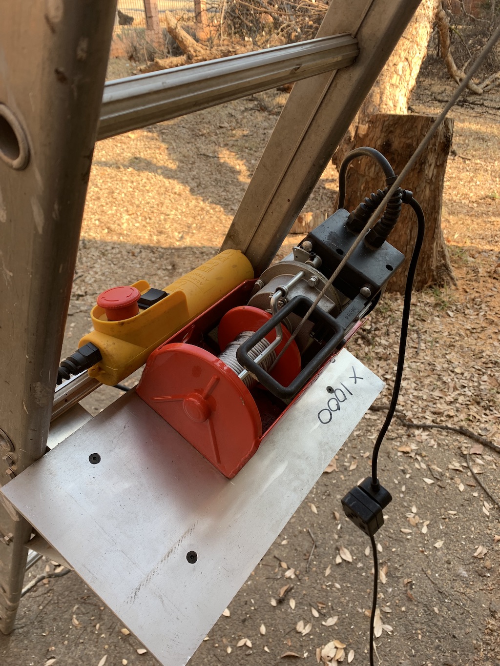

Was not favouring carrying 30 x 2m panels up in windy conditions. Made me own:
Quite clever using a vertical winch/hoist like that! Even more so if you could build it yourself.
