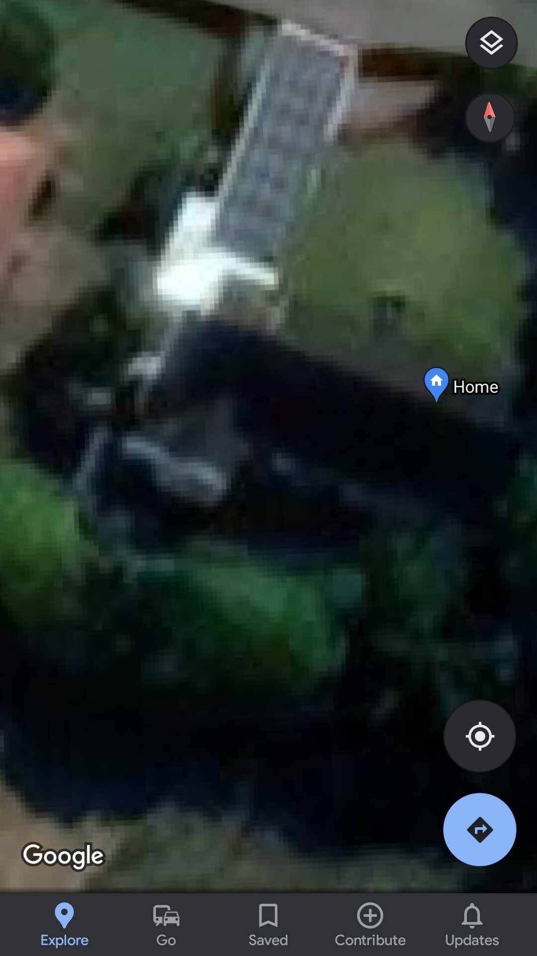

So it should be easy to spot your house in Bridgewater. It’s the one with the big-*ss solar array :joy:
Goeie Genade. That is quite good. What is your panels angle and direction?
Nearly flat on my carport. 10° facing NW
