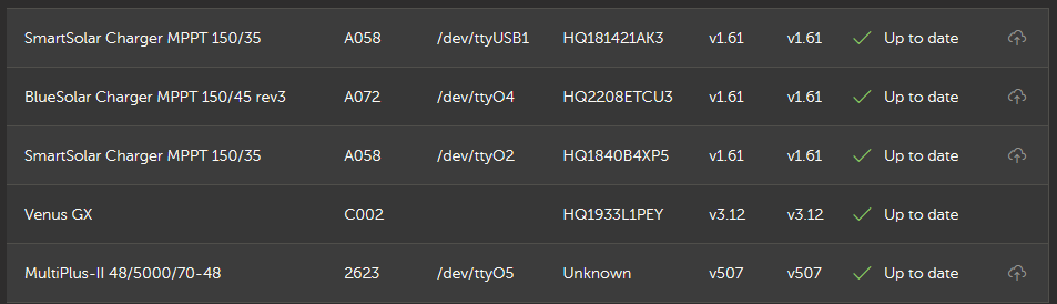

This morning I tried to update the Venus. It showed as version 3.12 and showed same must be updated.
Well it was seemingly unsuccessful as I got an error that there was no response from the GX device during the upload process, but two way communication is enabled.
Then when I exited, and checked/scanned again, it showed the GX as up to date now, but still with V3.12???

Could the MK3 that needed to be updated, have anything to do with the Pylontech displaying?
Venus was updated, and then the warning came up on the inverter re. must update the MK3.

Just do it. This has happened automatically for years, but there is a very very small chance the inverter might restart during the update (and drop your power), which is why it is now a manual thing. At least this one time.
All is updated.

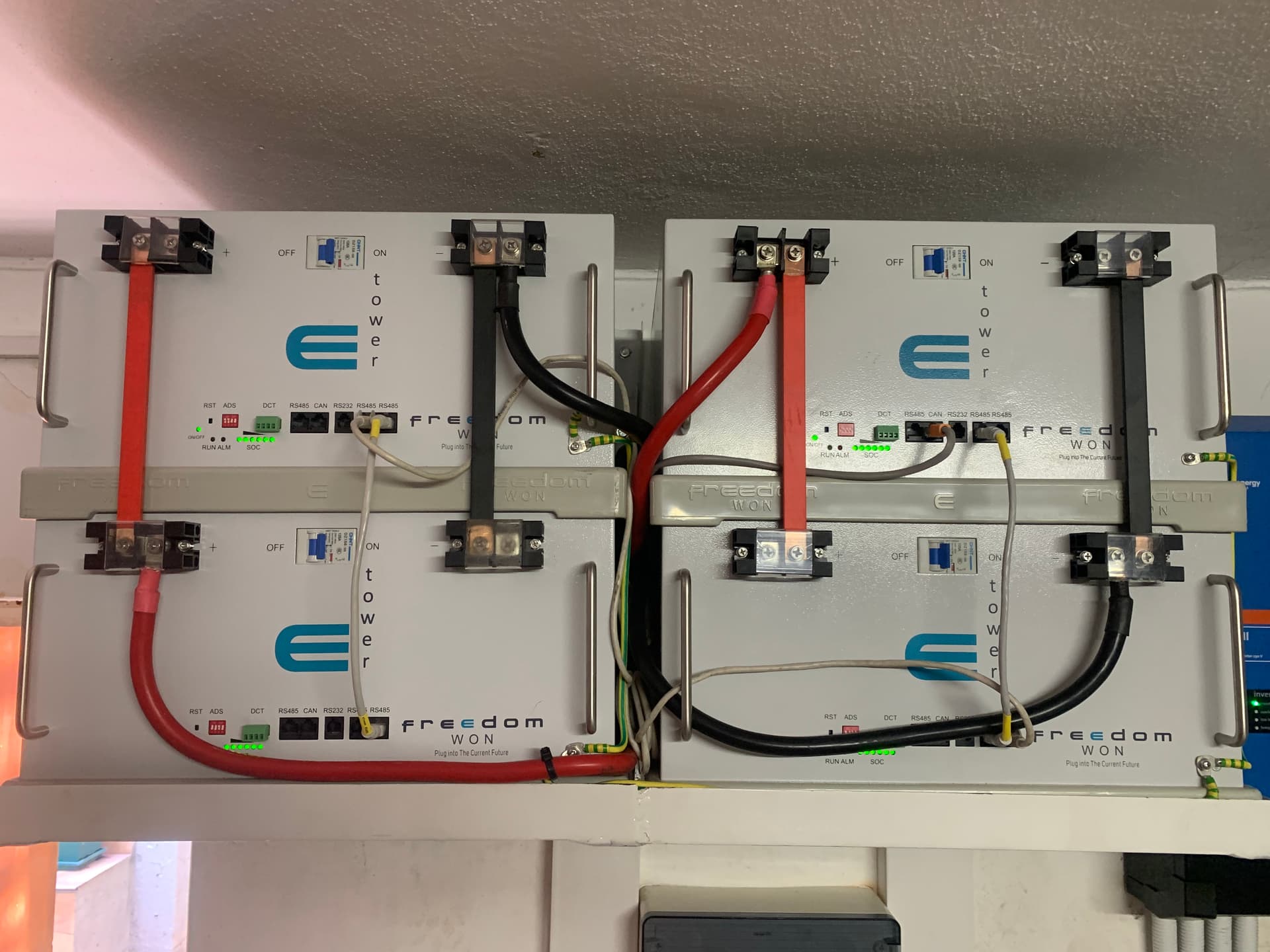

Please send a picture of the final battery installation. I think I know what they did.
I am trying to find your number to give you a call but must have lost it when I changed phones. Please PM it to me
Stand by, going to take a pic now.
Here it is.

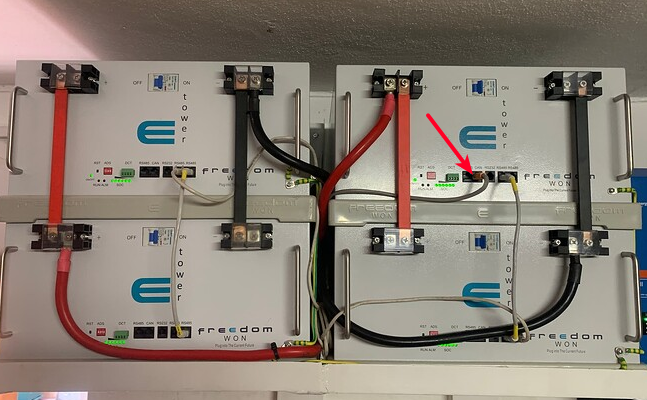

Yup, they made the new battery the master.
Selection_606
Move the CAN cable to bottom right.
Then redetect.
We just reconfigured the setup.
1 = Top left
2 = Bottom left
3 = Bottom Right
4 = Top Right
