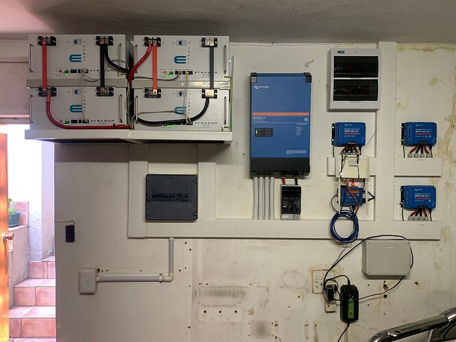

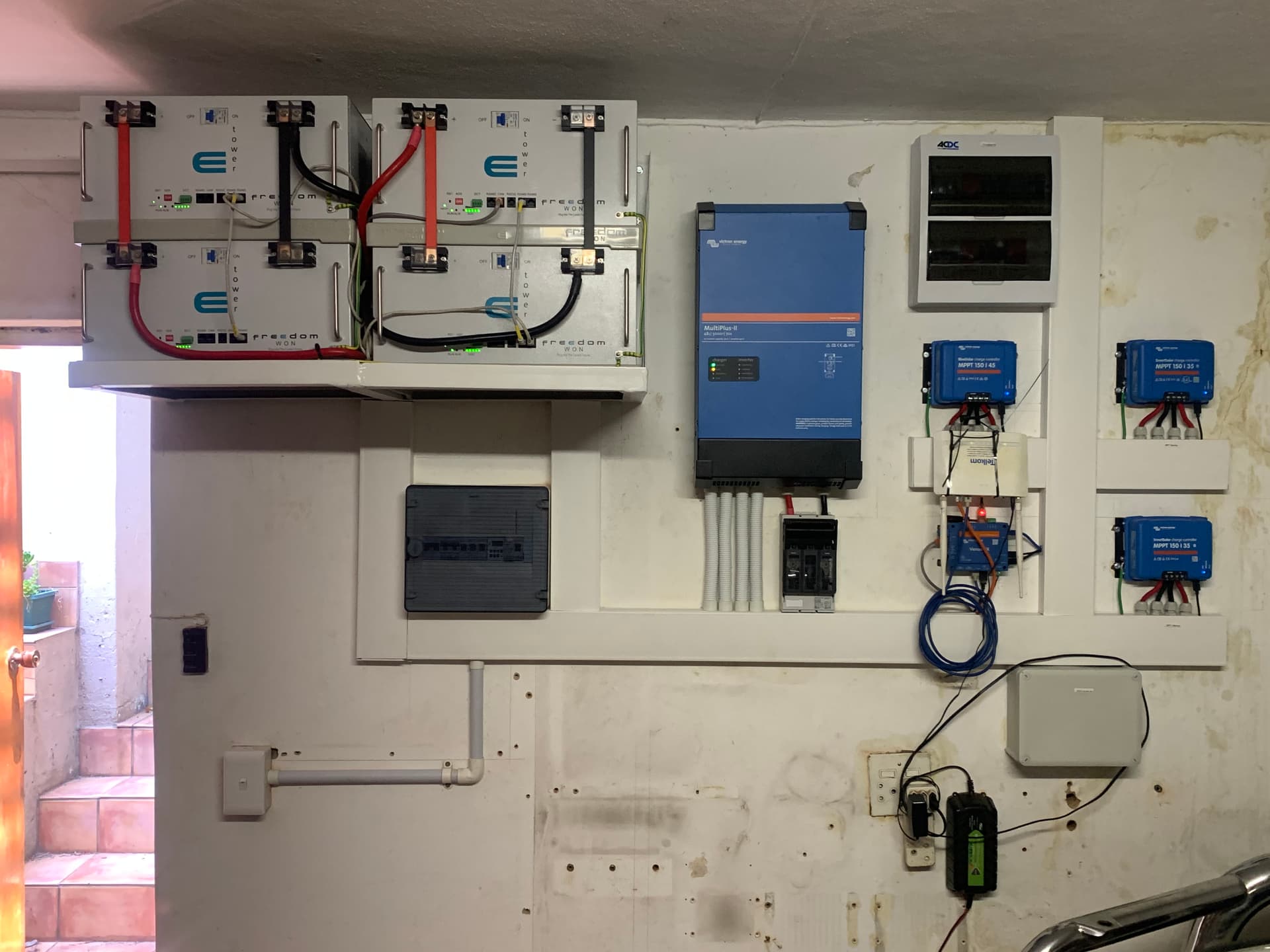

So the void has been filled.
Very impressed with how the system is performing, save for one little thing. I know this has been discussed a number of times in various threads but I cant seem to find one of the relevant ones now.
I also seem to recall that this could be due to a number of reasons but, the BMS/GX now only allows an 98% SOC.

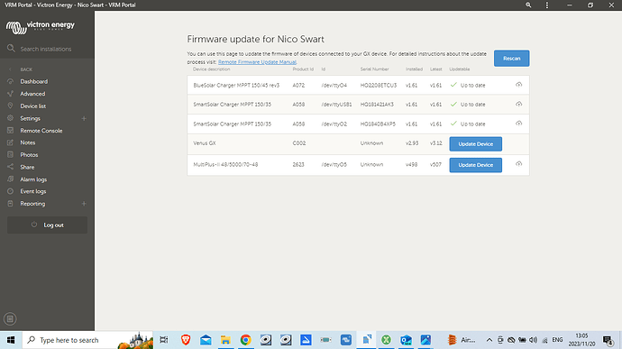

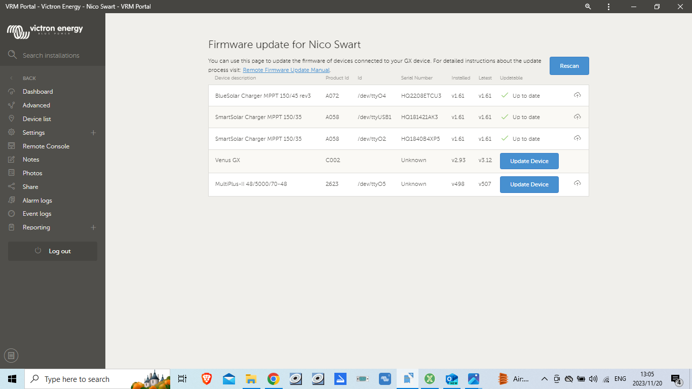

I’ve also managed to see that the 1st 2 MPPT’s is on version 1.61 and the new one still on 1.59
Ok clever me at least got something right.
Managed to updated the MPPT.
Not even going to attempt the Venus or the Multi as this will be a stuff up. TTT usually does this for me. :grinning:

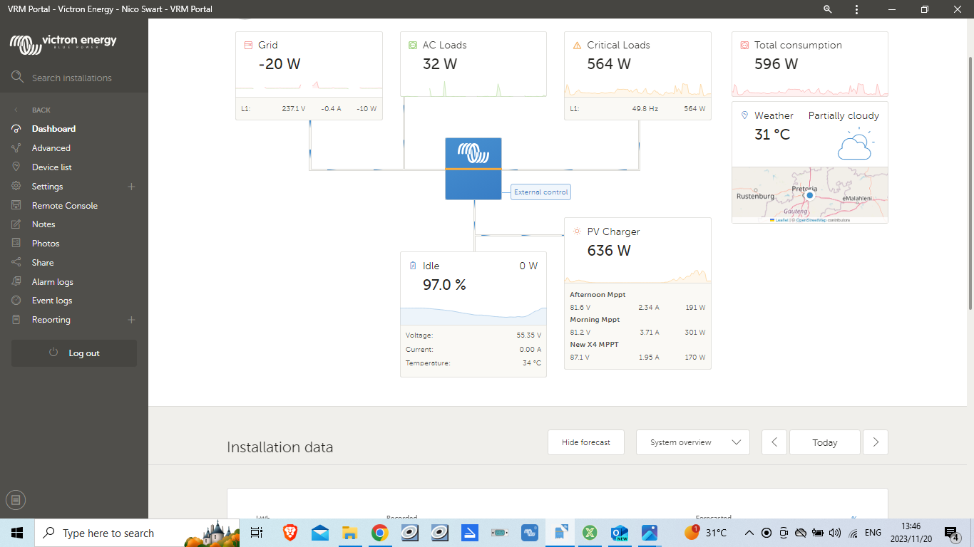

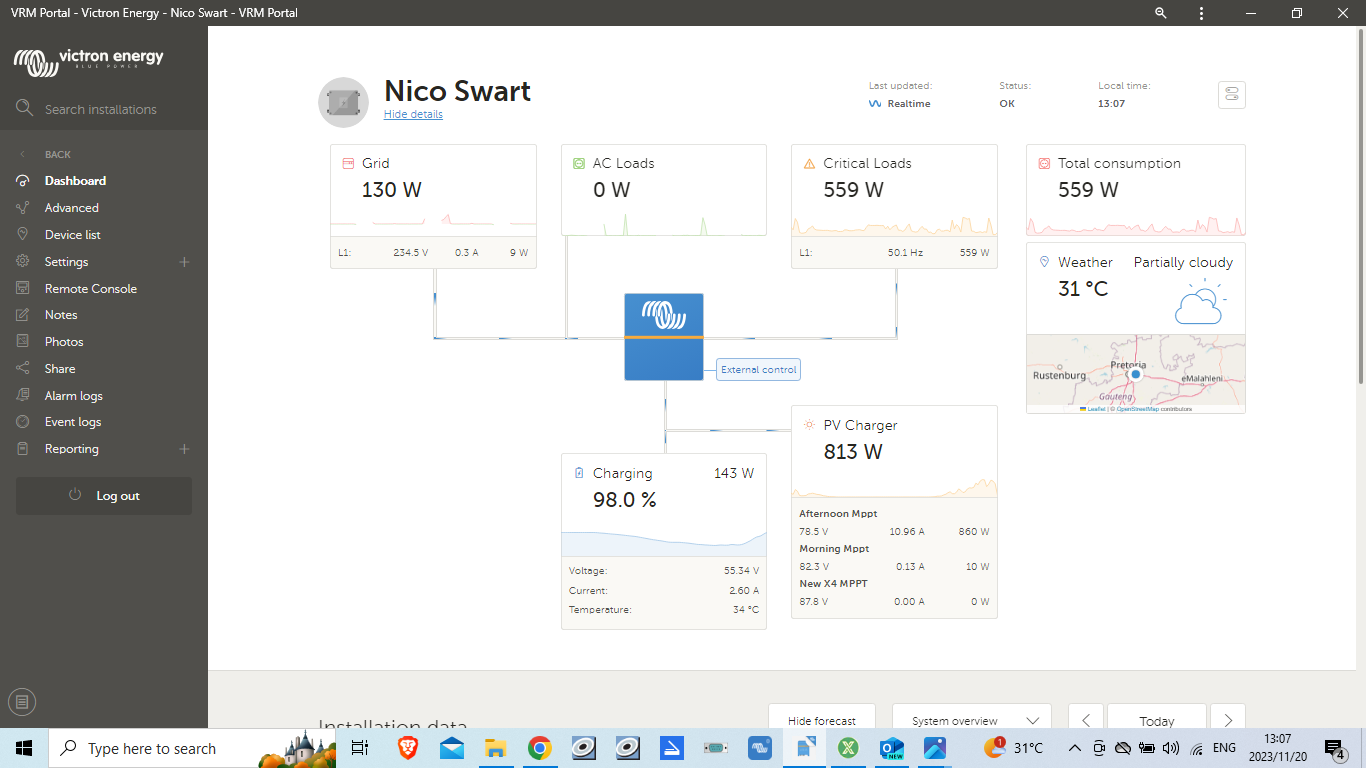

See here, holding steady at 98%
My FW tends to sit at 99% for a while before the last step to 100%. Might this be the cell balancing phase?
Perfectly fine, balancing taking place if you check the 143w, 2.6a still going into the batt.
Leave it be for a few weeks.
This now after the update of the MPPT.
97% and zero amps.
Mine reaches 98%, and now 97% before 12h00 and then stays there the entire day. If I switch to keep batteries charged, Eskom jumps on the wagon despite there being ample PV.
EDIT. Tried it again now after the update and it seems that PV is being used now and battery is accepting amps.
2ND EDIT Spoke to soon. Sitting at 98% again and no amps in.

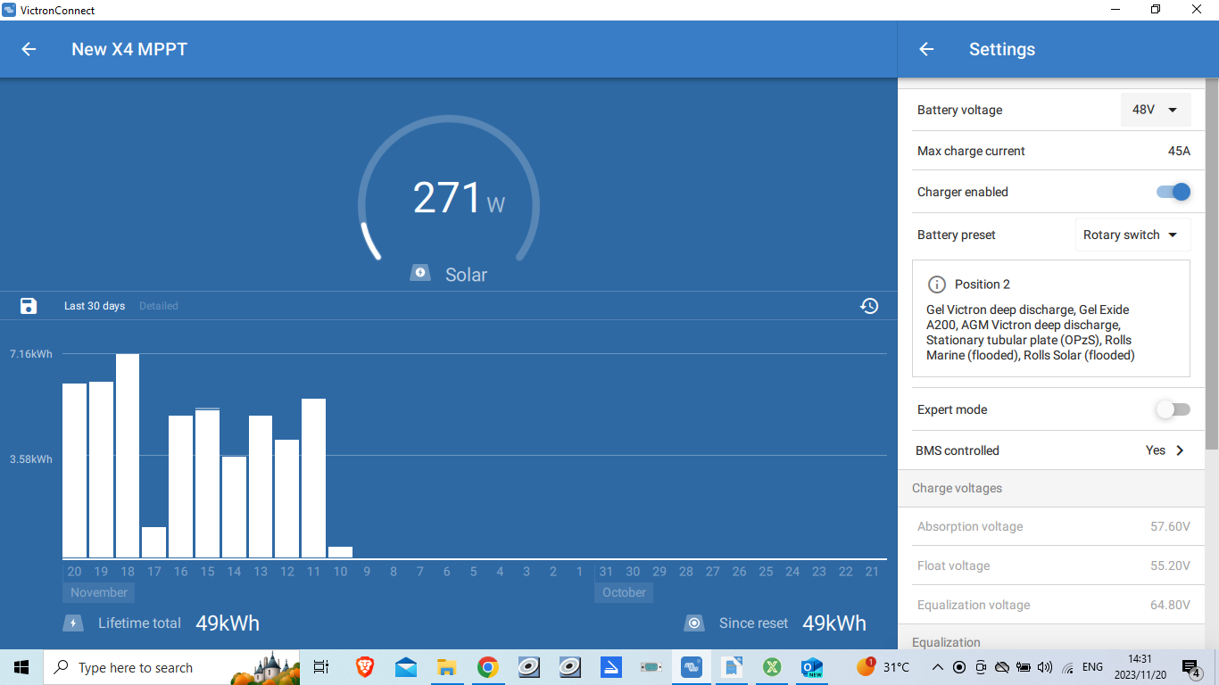

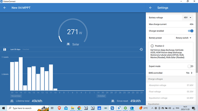

Hold the phone guys. It seems I’m able to access my non Bluetooth MPPT through the Victron Connect App on my PC.
Checking the settings now.

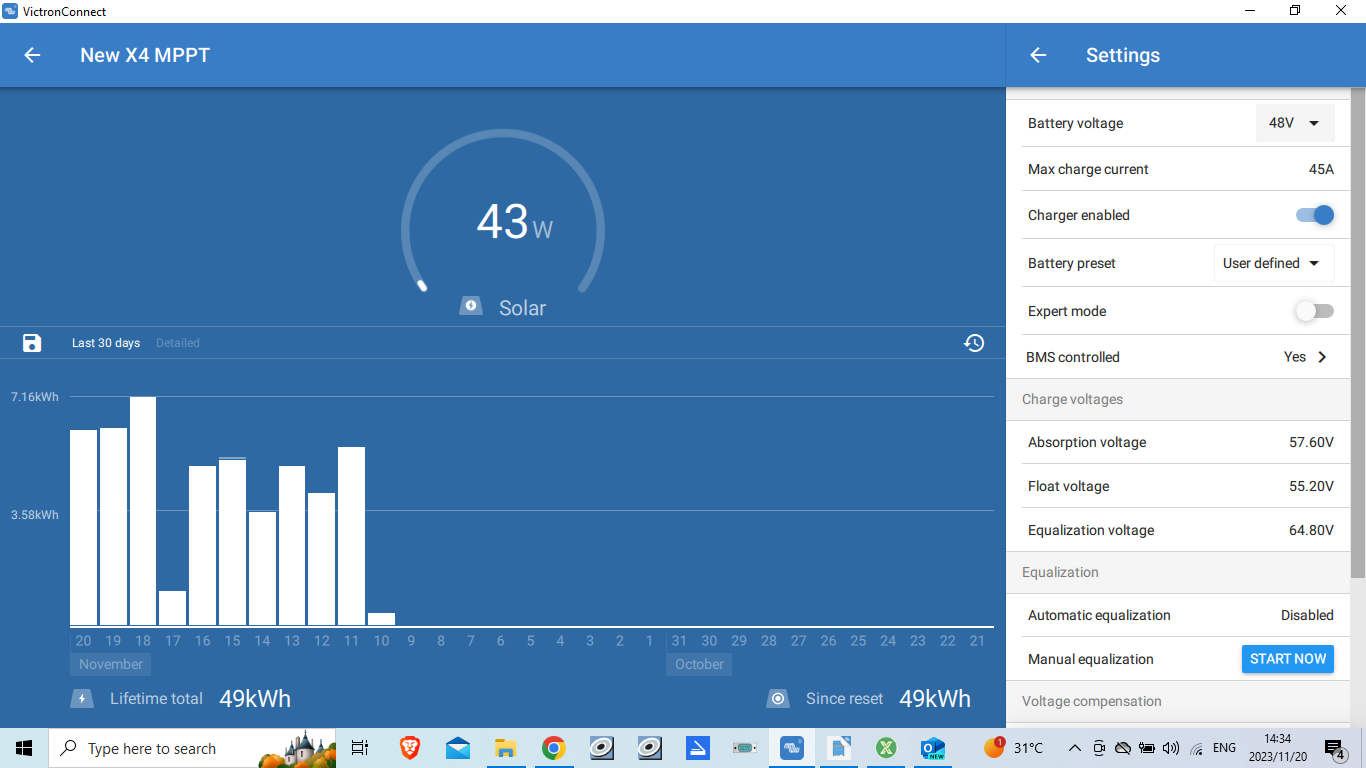

And this does not look lekker.
The other 2 MPPT’s are set as user defined.
Absorption and float voltages also completely different!!!
On my other 2 they are both 55,8V
This is the new one.
What should equalization voltage be?
On the new one it was set to 67V
On my other two these are disabled. How do I disable it? If I type in 0 Volt it automatically sets it at 32V.
