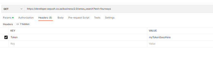

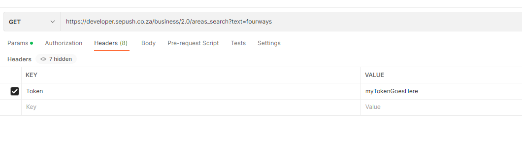

Using “https://reqbin.com/curl” I always get " Cannot process your request."…
As you can see… tech knowledge low in this area

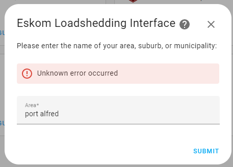

OK… got my area id but…  after I enter my API Key Ai ;(.
Done a full remove of everything and reinstalled… Numerous restarts of HA…

Thanks @Phil.g00 - sorted this bit already - just can’t get the Integration reinstalled now… Accepts API Key but not Area:
I get the error above…
Resolved:  API calls Quota must have been used up.  No fancy error but all good this morning!

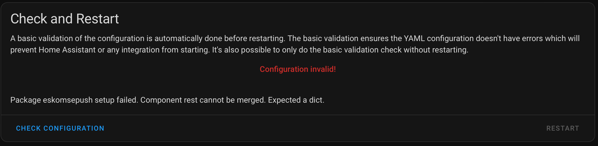

Yes. Was too lazy to rollback.
Only way I could get it to validate was to move it back to configuration.yaml
 , yes, but makes my config look very messy.
Seems there is already a bug reported

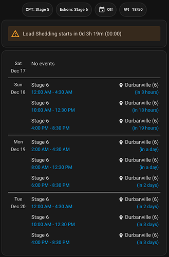

Yeah so that is a HACS repository. Once you have it installed, on that same github repository is links to have some nice cards in home assistant. This is what mine looks like using the provided examples:
When you copy the example code, you still need to edit it and use the entities that correlate to your own area. In my case, Durbanville zone 6.
