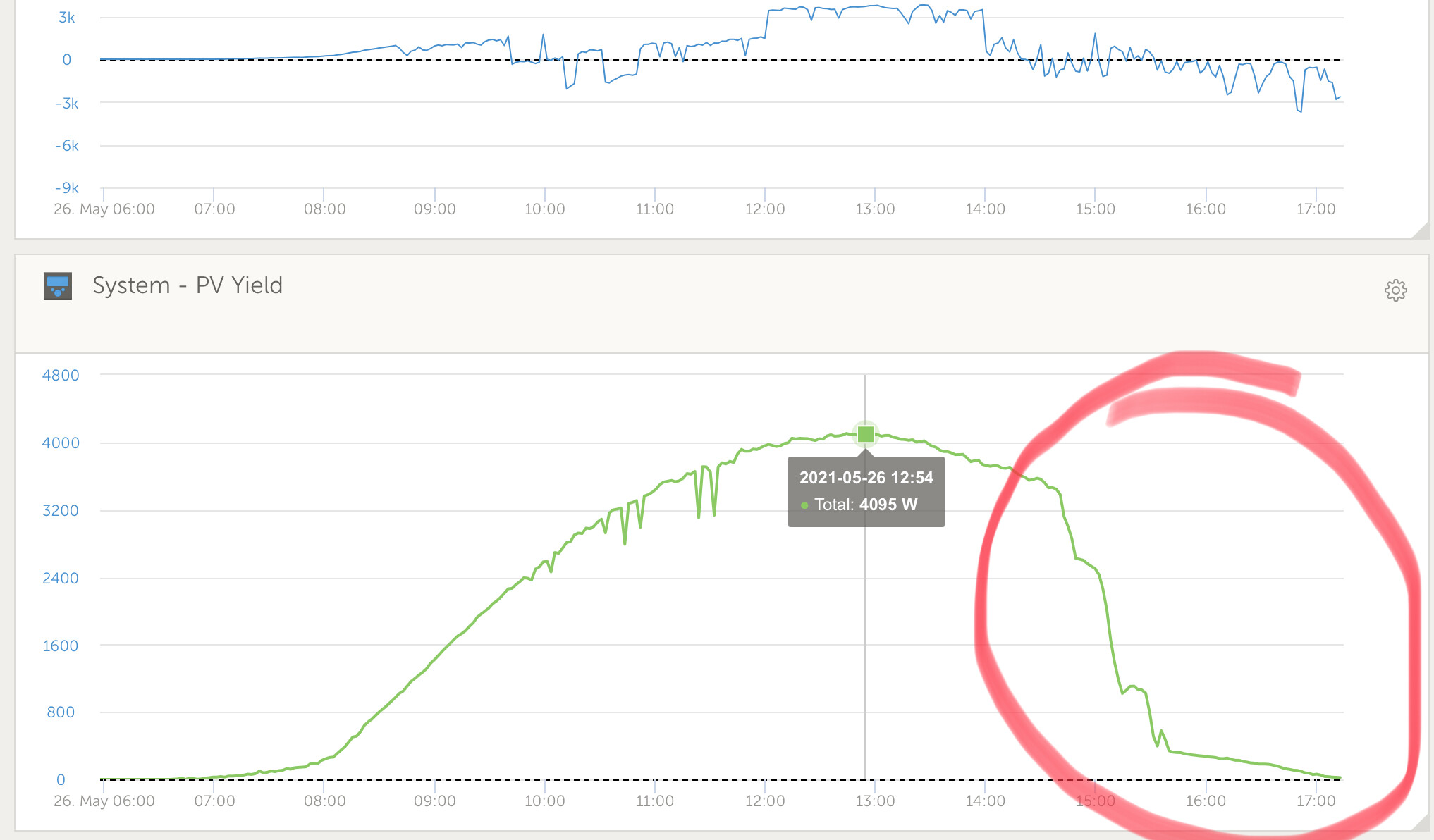

Back to my system… this was today’s PV curve with batt power on top:
I am probably losing 3-4kwh due to the 3pm shading, combined with too low inclination, and 15 deg off north. So if I move these panels to the rear roof, And mount them at a more steep inclination I should get quite a bit more out. But I will need about another 25m cable run, with some more losses at the 32A I am drawing from the panels.
