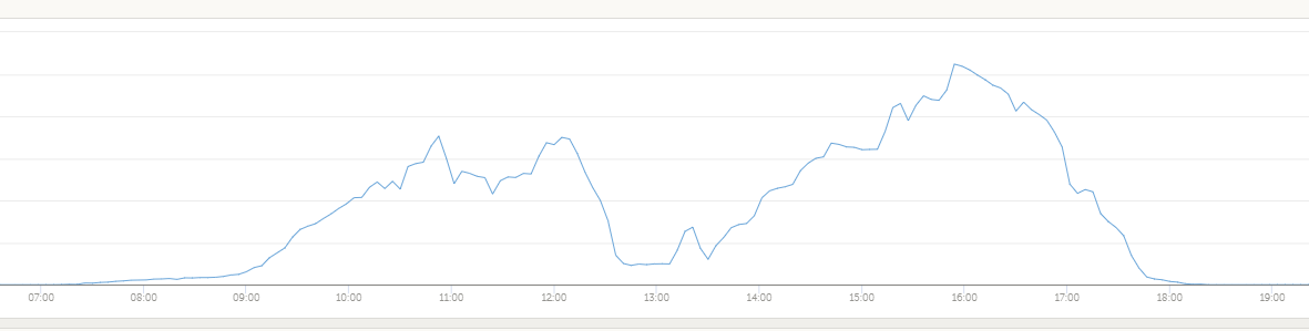

When installed, in October, the PV graph for that array was nice and bell shaped.
Come March, there started to be a dip around lunch time, before returning to a nice peak at around 3 - 4pm:
At first I was concerned; was my MPPT playing up, a wiring issue maybe?
Then I went for a walk outside at 12 one day to see what was up, and saw this guy casting a big-ass shadow over all 6 panels:
Turns out, as we get closer to winter, the sun has moved in a manner that sends it behind the Christmas tree over the peak period.
So, since neither my wife nor I actually like the Christmas tree, we’re going to get it removed, and replace it with a smaller tree (but one that still gives shade to the garden). And, since it’s costing me PV production, I can actually work out how much that replacement with “earn” me.

Now, I can estimate how much PV production the tree is costing me. Eye-balling the graph, I conservatively estimate around 3kWh a day. Since it’s autumn, and going to get worse, I’ll keep that as a year-round average.
Cost per kWh in CT is currently R2.91, which means I need to generate ~4450kWh to replace the tree, assuming no electricity price hikes.
So, payback period is about 4 years, probably 3 after price hikes are factored in.
