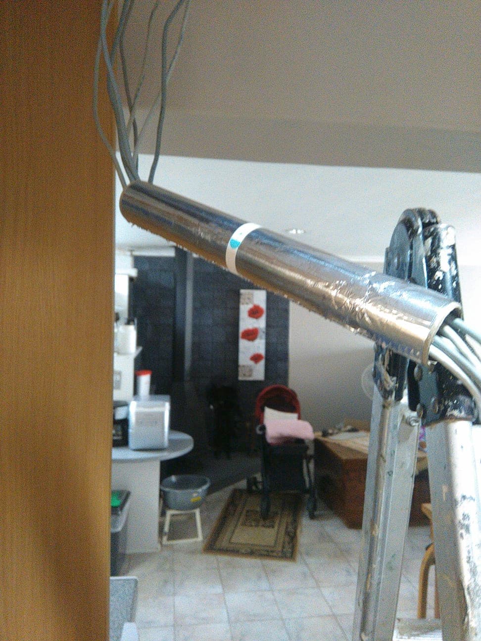

  1. O, lest I forget … started having frequent network router feezes. UTP cables right next to AC wires through a hole in the wall. Been like that for years and NOW suddenly I’m having issues. WTF!
Where both have to go through a hole in the wall … there, I fixed it.
Grabbed one of the wife’s new tinfoil rolls and stuck it in the hole in the wall with the UTP cables inside. Also made sure no UTP cables are anywhere near AC wires. Will see if the problem is now solved.

That was a major “change” I did to fix the intermittent router freezes, to keep the AC away from the UTP cables through a wall, that was never a problem for 10 years.
Only became aware of 8am LS at 9:10am … because the inverter is working.
Nothing else changed. I cannot fathom how a tinfoil roll can make a difference.

Jip, I am so going to buy more tinfoil rolls. Another LS event and no errors at all on the original inverter.
Someone asked me, do you have vibrations in the house?
Nope, I said, why?
Ghosts … he said.
One tinfoil roll to insolate UTP cables next to AC wires, nee man, dit maak mos nou wragtag nie sin nie.

  1. The tinfoil rol, was the last move. Routers are more stable but not perfect yet. Process of elimination left.
But I do want to get an idea to consider what the chances are that AC is close to the VE.Direct cables, or maybe the UTP cable to the Cerbo, could have been a contributing factor, the MPPT/s switched off eliminating the error … grabbing at straws here, I know.

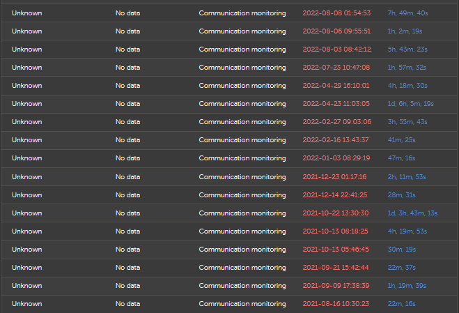

When I speak of router errors … I mean a LOT of them, the 2 recently, the part I still need to find where.
