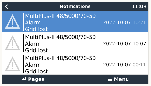

Will be switching off the DB going forward, as I have done at 10:21, and will be doing the same on Sat and Sun and Mo … untill said promises are kept.
I am leaning towards my inverter being faulty but each and every time I think “YES! Gotcha!” … the joke is turned back on me.
LS is over … for now.

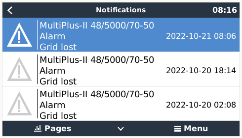

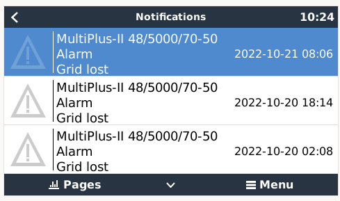

Update.
As previously noted, my inverter tested perfectly at the Victron repair center.
With the test unit for weeks, and my unit for a few weeks, not one problem.
The loan unit had to go back.
This morning, the first 8 am slot in weeks, I get the same error as before.
Geez I lost it … switched off all the panels again and it was fine.
