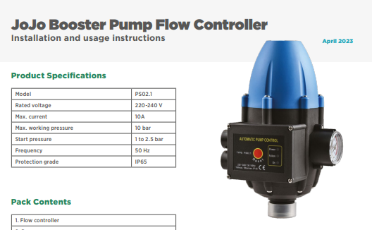

The valve is fairly new. Could it be that the pump is delivering, or expecting a pressure that is a bit higher than reality?
Could be - the older flow controllers had an adjustable spring you could turn to set the pressure detection. Newer ones don’t have that.

My pump has a setting for output pressure (easily adjusted) but I don’t know what it should be. Also you can tweak the sensitivity and the time it runs on after demand stops, but you have to work out some ratios and the manual doesn’t give much detail. So it’s either for people who know what they are doing, or to stop people fiddling with stuff they don’t understand (or both, and I am not in the first category).
