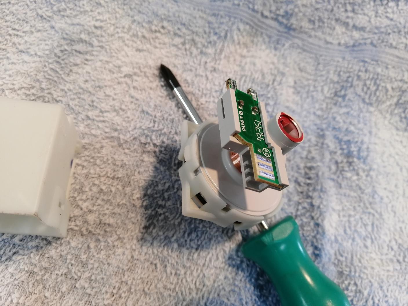

i just stumbled across this video which suggest i have to open it and adjust the screw… or shorten the spring… and re-seal it Inside a washing machine water level transducer. (schematic) - YouTube

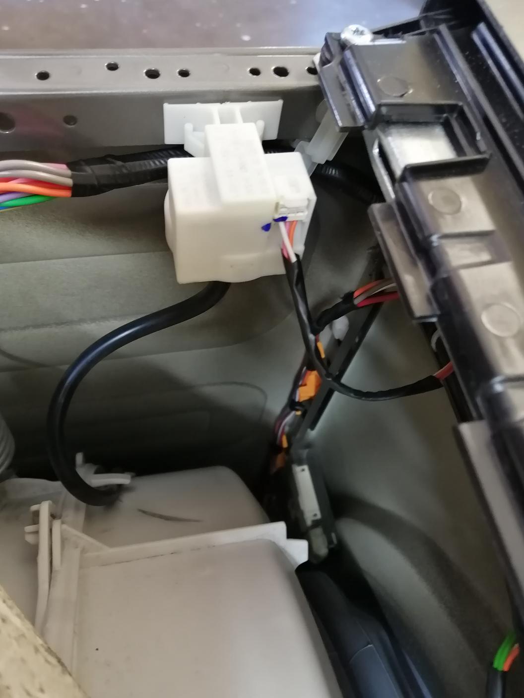

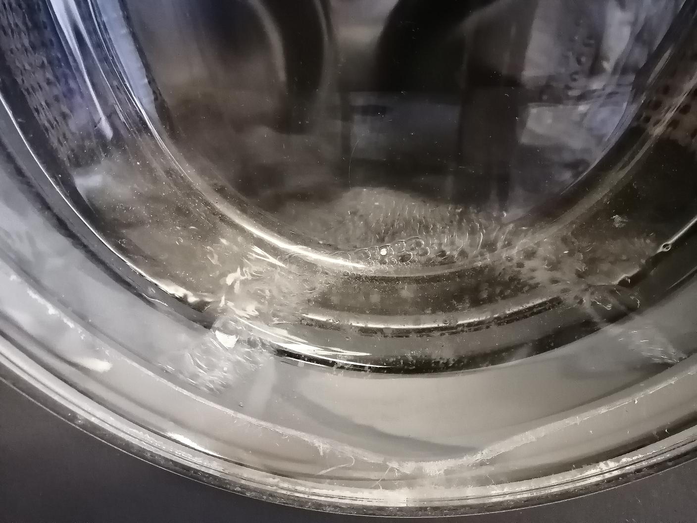

i took the little unit, see images to follow, prized it open, took out the inside, turned the screw one full turn clockwise, reassembled and re-fitted and VOILA, AT LEAST 5 LITER GAIN - GONE ARE THE HOSEPIPE DAYS!
note: the switches cost approx R0,5 to manufacture but sell for R400!!! to prevent you the consumer from adjusting the setting it is placed inside a flimsy housing!
