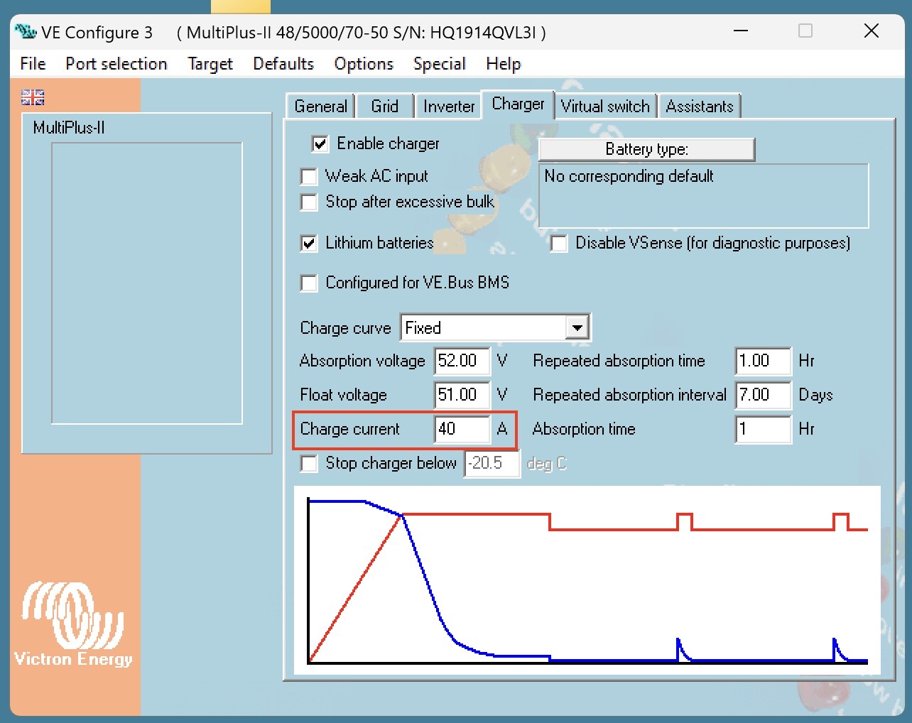

In VeConfig, under charger tab - on his system (3k mpII) it was configured at 15A and on mine (5k mpII) is configured at 40A.
What I did on his, I increased it to 35A and the charging became as intended @35A so the two US3000C’s charged fairly quickly.
I thought that pylontech manages all this but then thinking again, this shows that it is “Maximum DC charge current” because when battery % came to around 95-98% it dropped down and charged at lower amperage.
Should this value be based on the inverter in question, e.g.
MultiPlus II 48/3000/35 - this should be set at 35A and on MultiPlus II 48/5000/70 should be set at 70A?

That is the charge limit that your batteries can handle and you should set it to something equal or smaller than your battery recommend.
When it’s only the Multiplus this value will be used. But when you add a link to a GX device you can override that. Then if your battery is linked to the GX and the DVCC option enabled then your battery will override that.
It’s always better to set each value in place, even though the Victron system do have many checks to prevent problems. There are still some rules where this value is king.
Must be based on what the battery bank can take, so what can the banks take, 1C, 0.5C?

Now for a single US3000, recommended charge current is 37A but a question now, if there are 4 batteries in parallel, should it be 37A for the complete bank or 37A x 4? (obviously up to the maximum current based on the inverter model)
I guess the latter part of my answer begs exactly this question :grin: :thinking:
EDIT:
Ok, so I did find the answer to that question :nerd_face:
Since recommended charging current for a single US3000 is 37A, when we have 2 or 4 in a bank the charging current needs to be multiplied by the number of batteries.
That said, in both scenarios it should be set to the max. DC amperage each Victron can produce since the banks are 37A x 2 = 74A and 37A x 4=148A, but the max amperage is 35A and 70A respectively.
