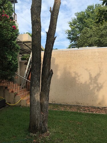

I think the best move for now is to get rid of my Bottle Brush tree, and merely gather data for the rest of the year like TTT also advised. Tree will hopefully be gone in the next 2 weeks, and I will report back as to my findings.

So referring to post 91 with pics of my Borrel Braaash⊠yesterday I had him halved in size.
This morning first light hit the panels at about 07h15, and then the blasted clouds showed up. Lots of rain predicted for the Gauteng area today and so I wasnât able to see when all panels will have full sun.
I estimate it to be around 07h45 and time will tell.
