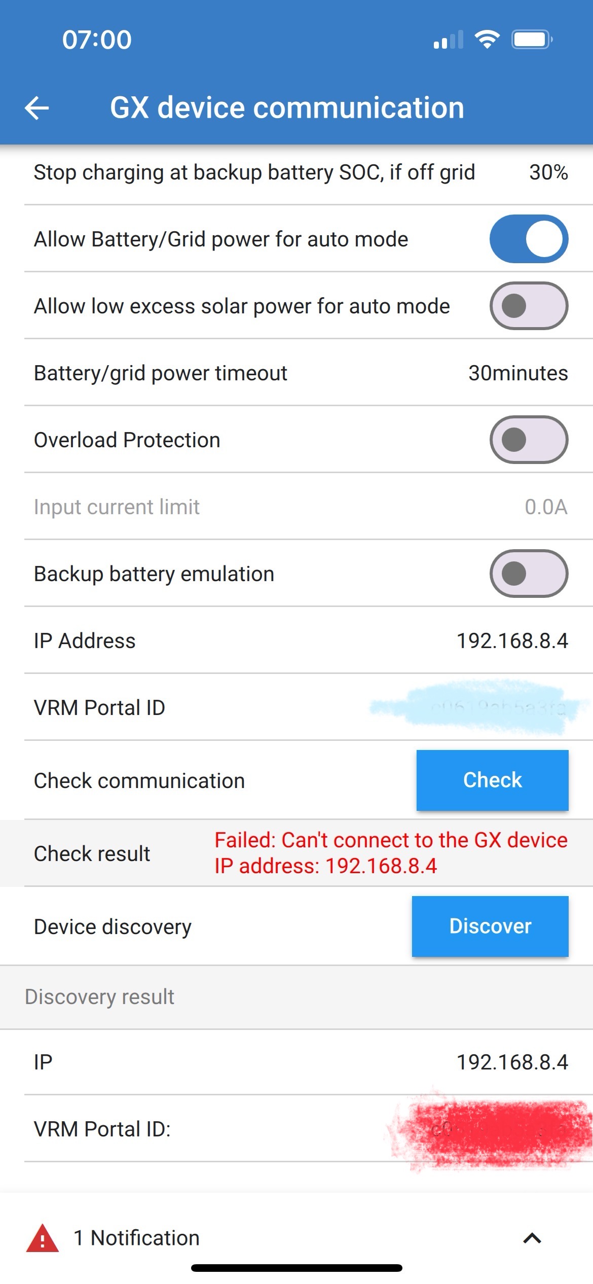

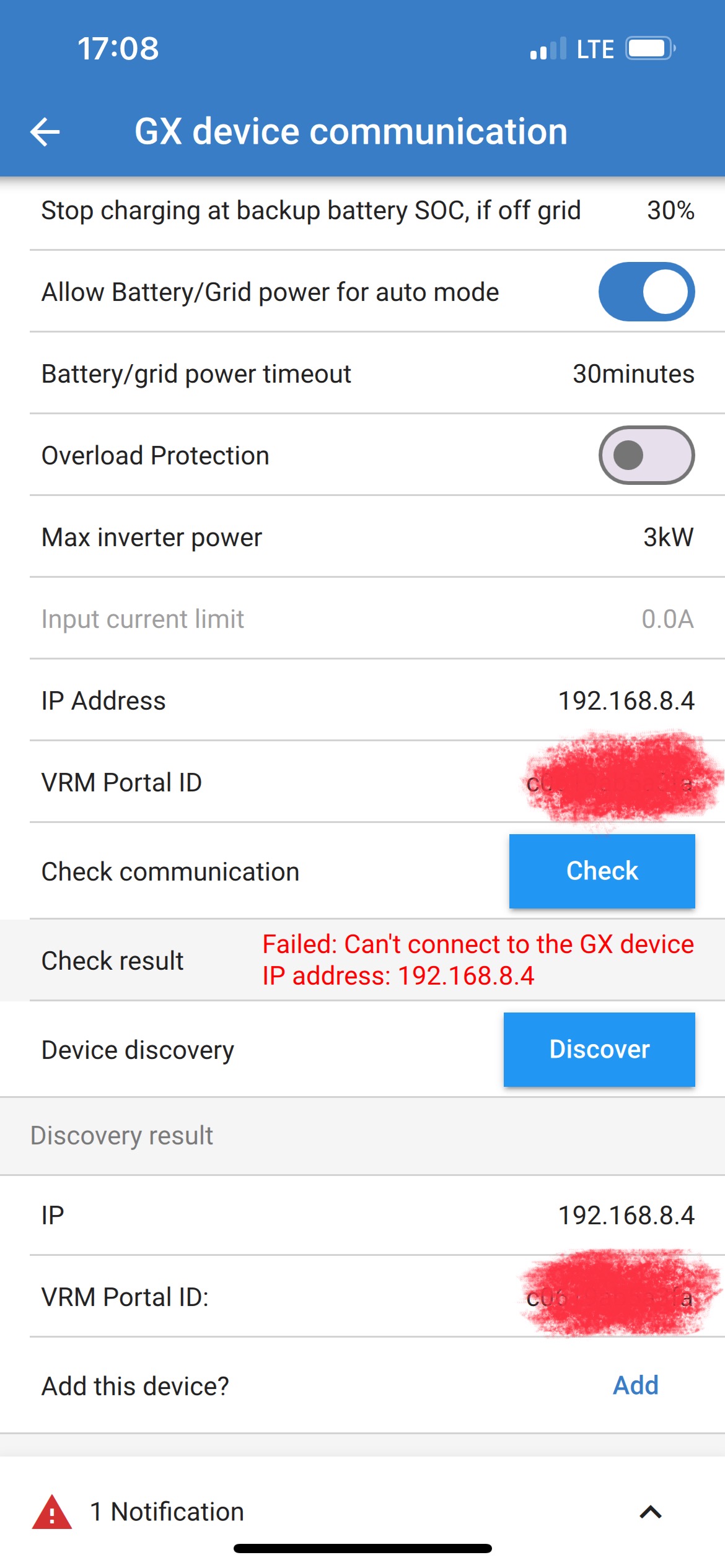

When the EVCS scans, it sees the Cerbo on its local network (check discovery result) but after adding the found device it fails. Why?

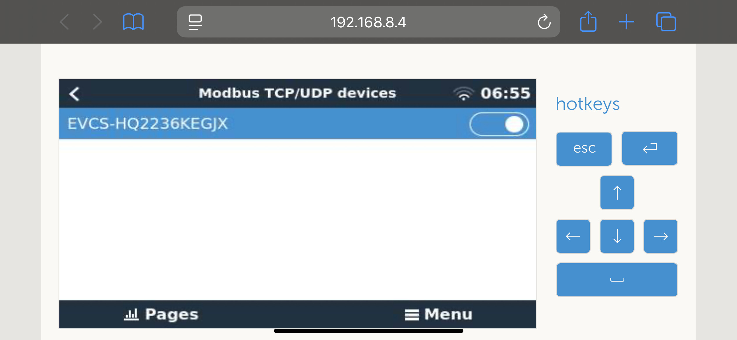

Did you turn on Modbus-TCP on the GX device?
Ok, I enabled it. The EVCS device is seen from the GX side. But the EVCS stil cant see the GX.
