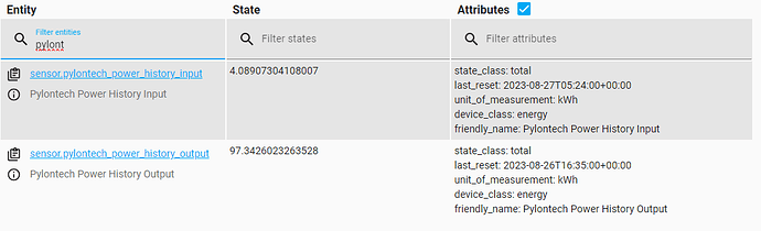

I’m also keen to get some help here. Node Red Flow to allow me to populate the Input and Output from the Battery Bank (Pylontech doesn’t supply the history value).
I have “sensor.victron_system_battery” but can’t seem to get the splitting of input and output correct to populate the HA sensor values for the HA Energy Dashboard (using Node Red)

This sensor gives you power into (pos value) and out of (neg value) but the trick is to split them and then send them to sensors for HA eDashboard to use…
I am here but the values don’t work well in the dash yet…
That’s where I am struggling. Using Node Red at the moment as I couldn’t get integrations working… ![]()

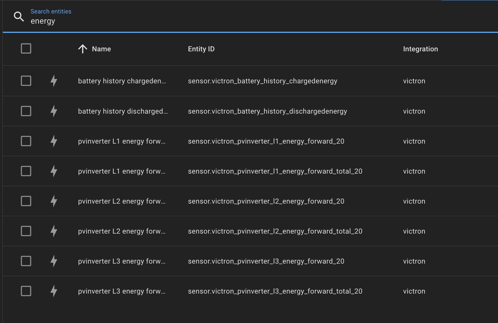

Just to be clear. The values you see on VRM (battery to loads, PV to loads, PV to batteries, etc), those values are not on modbus/dbus.
For any device that has energy counters, that is available. For example, on a grid meter on register 2603-2608. On a pvinverter on 1030, 1034, 1038. On the Multi, 74 to 92. On a battery, registers 301 and 302 (but only if the monitor implements it, a BMV does, a Pylontech does not).
