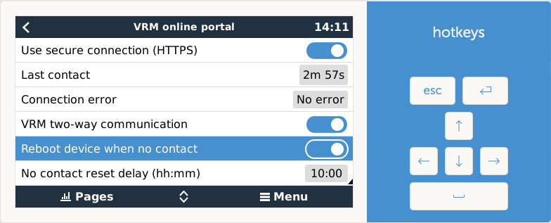

Also turn this option On under Settings/VRM Online Portal to avoid having to do unplug and fiddle again
Brilliant. Thank you.
