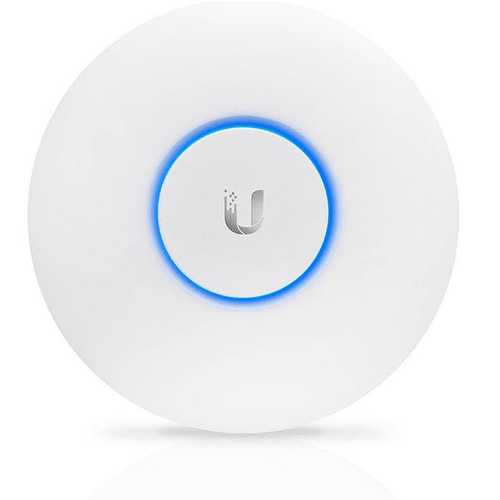

I needed 4 ⊠due to concrete slabs and windows, double story - all for phones Wifi.
The costs ⊠should have been a couple of thousand - what do they cost today, ±R2k or whatever per point, I got the wires in place.
Truth be told, in the end, it was âan aircon that I did not use anymoreâ price as he removed a bunch of Ubiquity points that someone else upgraded and had chucked.
⊠he also threw in a Firewall on a Hyper-V for me too, as part of the deal, to make the network secure.
These things:
They also come with really cool software to manage them.

I had similar issues, not the same, with various wireless access points.
Just upgrade them to a better make/model. I got 2nd hand Ubiquity dedicated wireless access points, and the problems went away.
