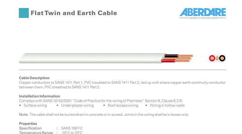

This old Aberdare pdf from July 2012 says yes.
If you go to the website now, see link, it doesn’t seem to say so anymore:
Both leaflets refer to section 6, clause 6.3.6, which is for ROUND twin and earth cables WITH METAL STIFFENING. PVC insulated multicore cables with a bare earthing conductor
and round cable with metal stiffening (the indication seems to be either is allowed).
So… seems the answer is NO YES…
Note: Edited to change NO to YES, I misread the SANS regulation and thought it must be round wire with metal stiffening. I also read that in a few other places, so I didn’t question it.

The exact wording in the 2017 edition is:
6.3.6 PVC insulated multicore cables with a bare earthing conductor and round cable with metal stiffening
6.3.6.1 The cables may be installed
a) on the surface
b) under plaster
The way I read this is that both “multicore cables with a bare earthing conductor” as well as “round cable with metal stiffening” may be installed under plaster, i.e. both surfix and twin-and-earth can be installed under plaster.
Edit: The fact that Aberdare states that their flat twin and earth cable complies with clause 6.3.6 seems to validate this interpretation.

Sorry to revive this old thread :slight_smile:
The latest Aberdare brochure has the “Under-plaster wiring” back:
(Sorry, I’m busy planning a downlights-install and was reading up on flat-twin and earth cable and came upon this thread!)
