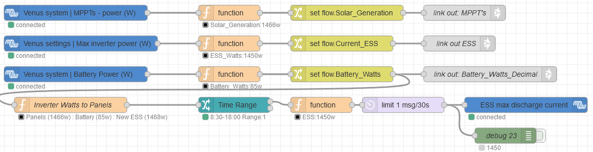

I have this to control the inverter max wattage to match the panels to cater for rainy days to not drain the batts to 20% and then they stay there.
Bottom left, 1450w, the inverter setting right now because the panel’s max watts are 1466w at the moment.

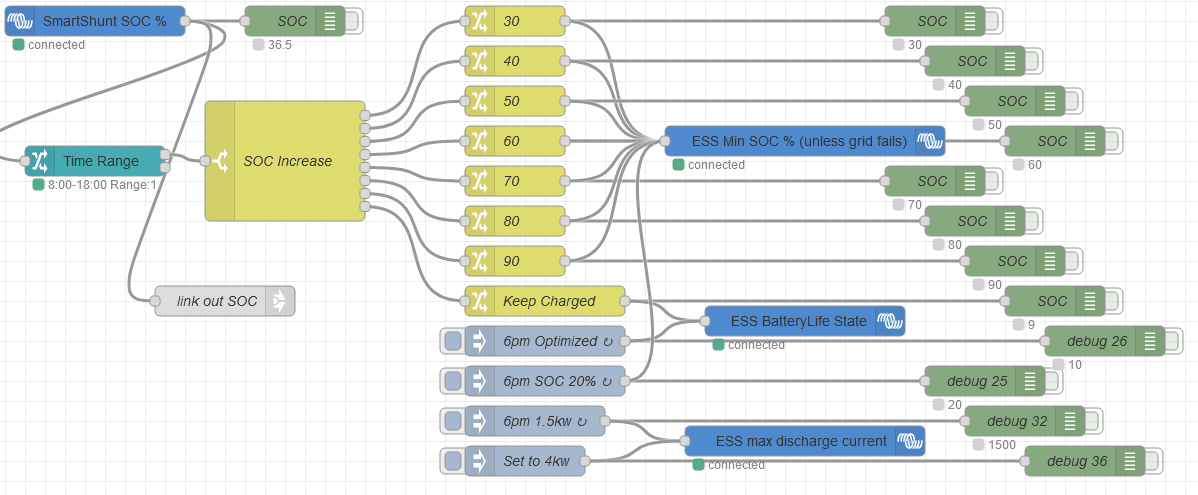

Then I have this to spread the batt usages over 24h by increasing the SOC during the day so I can use batts at night, LS is only “worried” about IF there is bad weather the next morning too.
Both the above are because of Cpt weather. With a huge Thank You! to @Paul who wrote it all, and adapted it for me to use on Venus OS Large.
