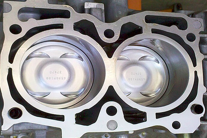

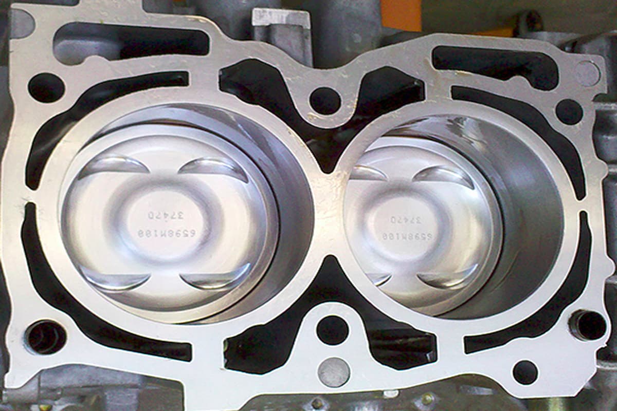

So you blew the head gasket. And the head itself sustained a little bit of damage in the process.
The head gasket is essentially a large seal does three things. It keeps the explosions inside the cylinders. It keeps the oil in the oil channels. And it keeps the water in the water channels. It is a big old seal that keeps oil, water, and explosions away from each other.
When a head gasket fails, you can get 1) water getting into the cylinders, 2) oil in the water or water in the oil, 3) exhaust gasses pushing into the cooling system, 4) exhaust gasses getting into the oil system, aka crankcase, 5) exhaust gasses getting into the adjacent cylinder.
In the case of water getting into the cylinder, the car will end up making a white smoke. Water vapour. If exhaust fumes get into the oil channels, you get smoke out of the dipstick hole. If it gets into the water channels, the water is “boiling” all the time, or you think it is, it will tend to blow the water out of the radiator/reservoir making you think it is boiling. If the leak is small, you may only see the coolant bubble. Coolant will discolour over time. If water gets into the oil, the oil gets a milkshake colour and consistency, or you might see a film of oil in the top of the radiator.
When this “seal” blows through, it creates a small channel between the block and the cylinder head (or top) where fluid can flow between two areas where it should not flow. In the case of exhaust gasses, flowing through this channel can also damage the material itself. So what your mechanic is telling you, is that when the gasket blew, it blew between cylinders 2 and 3, and while the engine was running in this condition, a little bit more damage occured to the cylinder head.
One would hope they at least skimmed the head to make sure it is perfectly flat. If you don’t do that… it will just blow again soon.

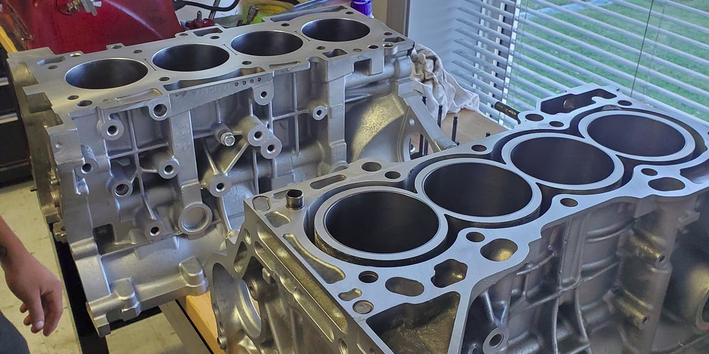

What’s kinda interesting between “cylinders 2 and 3”, is this. In a 4 cylinder engine the outer two pistons move together, and the inner two move together. So that the engine is balanced. The firing order is 1-3-4-2, which means cylinder 2 has an intake stroke when cylinder 3 has a power stroke, and vice versa. That means that a hole between cylinders 2 and 3 means some of the exhaust gas is pushed into the neighbouring cylinder instead of out via the exhaust. Or that is my guess. So you were doing some internal EGR (exhaust gas recirculation) via the head gasket
Edit: Even worse, when one cylinder has a compression stroke, the other is having an exhaust stroke, which means a part of the compression (needed for ignition on a Diesel) was escaping towards its neighbour which has the exhaust valve open. Car probably ran like crap, right?
In an engine this old it is probably not an “open deck” design. Your newer stuff is open deck, or semi-open deck, so this really cannot happen (I’m wrong… of course it can happen). Picture… one in the back is closed deck. One in the front is open deck.
