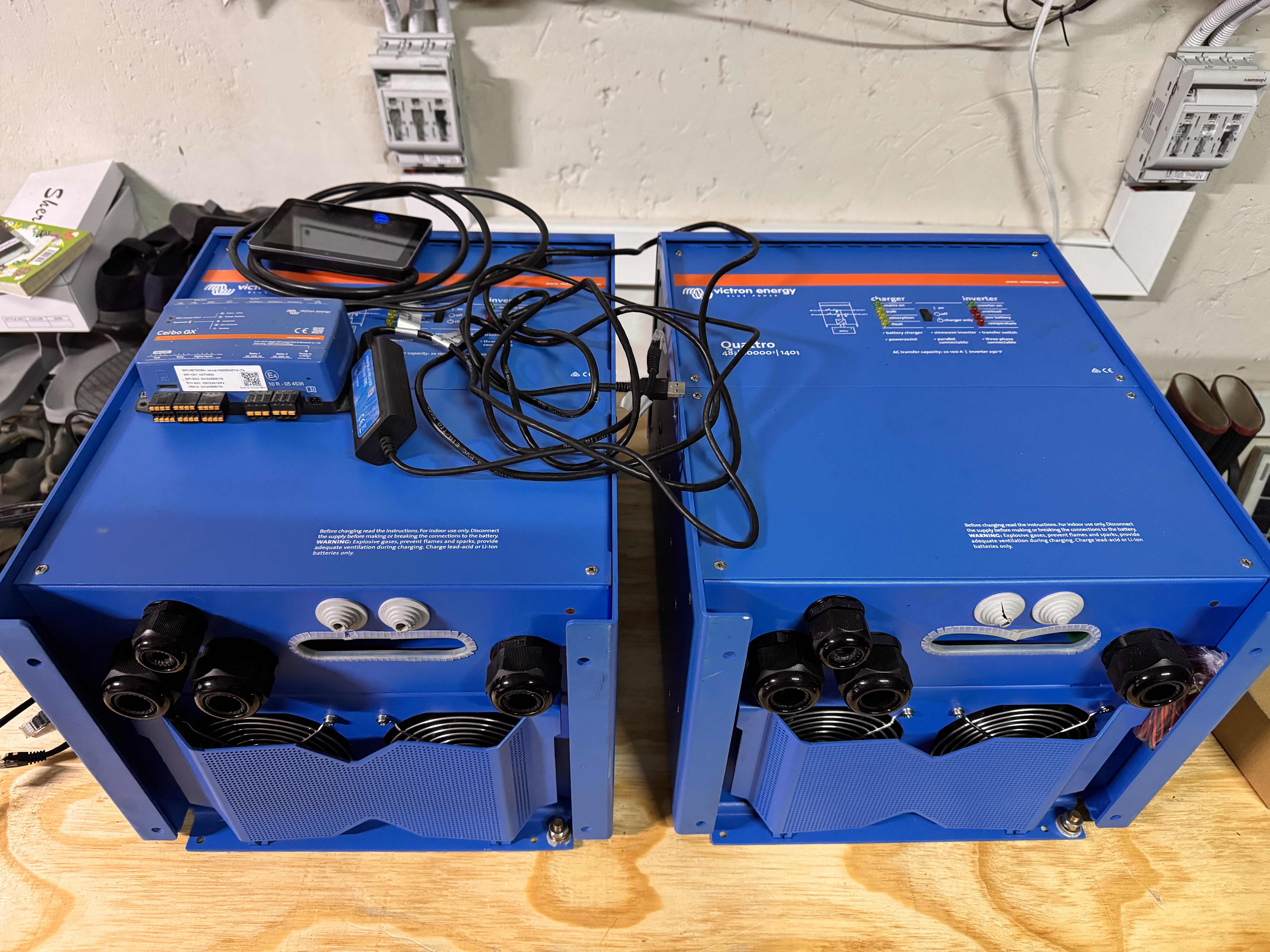

My toys finally arrived. These things are really huge and heavy compared to the Sunsynks.

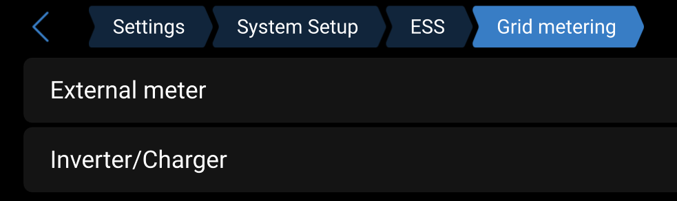

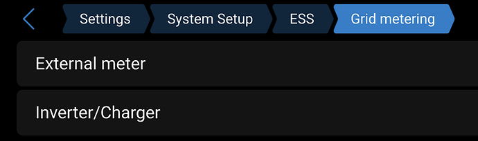

@plonkster Is this new to the new Q and MP? I don’t remember the MPII (5 years ago) having this functionality (I could be wrong). I needed the ET112 on the Grid feed…

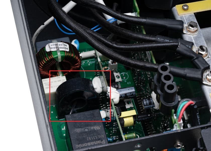

The Multiplus and Quattro inverters have always had current sensors on their input side (which they use for PowerAssist, even when not using ESS), and since at least somewhere in 2017, even before support for the ET112 was added, you could use those to regulate ESS.
Edit: Just to be clear, I am not talking about the CTs that used plug in with a 3.5mm jack, or that connects with a terminal these days. I mean built into the Quattros and Multiplus, there is a CT soldered into the main board that does this… example…
Thats very interesting - so I theoretically can toss my ET112 and use the internal.
So the Cerbo sees the internal meter (ie inverter charger)
All my loads go through the MP so I guess thats also NB.
So the next question… why the ET112 …
So that if you have an installation where it is hard to rewire things… you don’t have to. I assume that is what you are asking?
Why this meter? Well, first only the EM24 was supported, but that was quite an expensive meter, and the way it accounts for total energy makes it less suitable for PV-inverters (no individual reverse energy counters). So support for the cheaper ET340 was added. And then for the ET112, because it is even cheaper when it’s a single-phase installation. And then the EM24 went out of production, and we had a global chip shortage, so support for the EM300 range was added, then they made their new meter, the EM500 series, so support for that was also added, but because of those same shortages, and backlogs on the EM540, support was also added for the ABB B-series meters… and finally Victron decided to just get their own energy meter, because that way you don’t have to dance to the tune of other makers.
