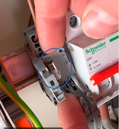

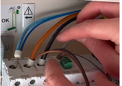

Normally you would just take the output from the AUX port. Sunsynk has 3 ports - almost like a Multiplus - 1. Incoming Grid; 2. Outgoing Backup; 3. AUX - which can be used as A generator input or a controlled output. I guess you could wire it to control contactors - that would save copper in this case. Just remember to add overcurrent protection to the control wires.
Oh yes! That! So many people forget that. The other day I was watching this short video, and was horrified for a split second when I saw this…
And then thankfully I noticed this before I made a complete fool of myself :slight_smile:
