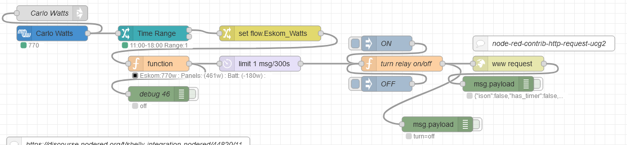

A sonoff and some node red/ha automations… Very easy.
As per Mark above.
What I did:
From 11am to 6pm (can be anything, setting still as per summer - bleh)
If Eskom draw is < 500w
AND Solar Production is more than 3500w
Then switch on geyser.
Check every 5 minutes if the above conditions are true.
Doing it with a Shelly relay controlled by NodeRED.
Notes:
  • From 11ish the batts are being recharged so the panels are at max. Batteries can wait.
  • IF another load comes on, more Eskom is drawn, what if it is kettle/MW which tends to be over before 5 min, hence the 5 minute delay. Or quick clouds.
  • If it is lunchtime cooking, geyser goes off, checked every 5 minutes.
  • And IF it is a bad solar day, the geyser temp drops below a set value, switch on and heat the water by whatever means necessary. “Safety net”.
KISS

I seldom have to do anything, because of the “Safety net”.
Are you using a Carlo Gavazzi to monitor the grid current etc?
Ja. I use the Single Phase ET112.
Yes, ET112.
