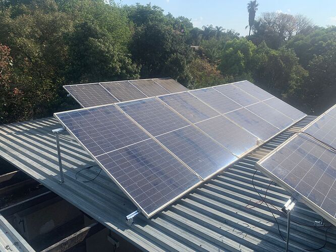

Here is a before photo taken from the house’s main roof.
Panels are going to be another 4 metres higher than this.
And this is what it currently looks like.

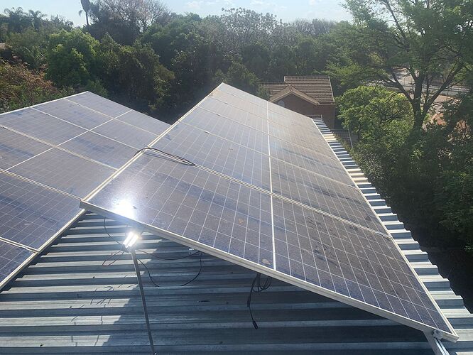

Here they are up top.

Remarkable difference! My baseline over these past few days was that before relocation, the panels produced 150W at 06h20
With all of them on top, this figure is now 600W at the same time. Very happy about this.
As I type this they’re up to 1128W at 06h50. Even with both my neighbors chopping down their trees this would not have been possible.
Sorted for years to come me thinks.
