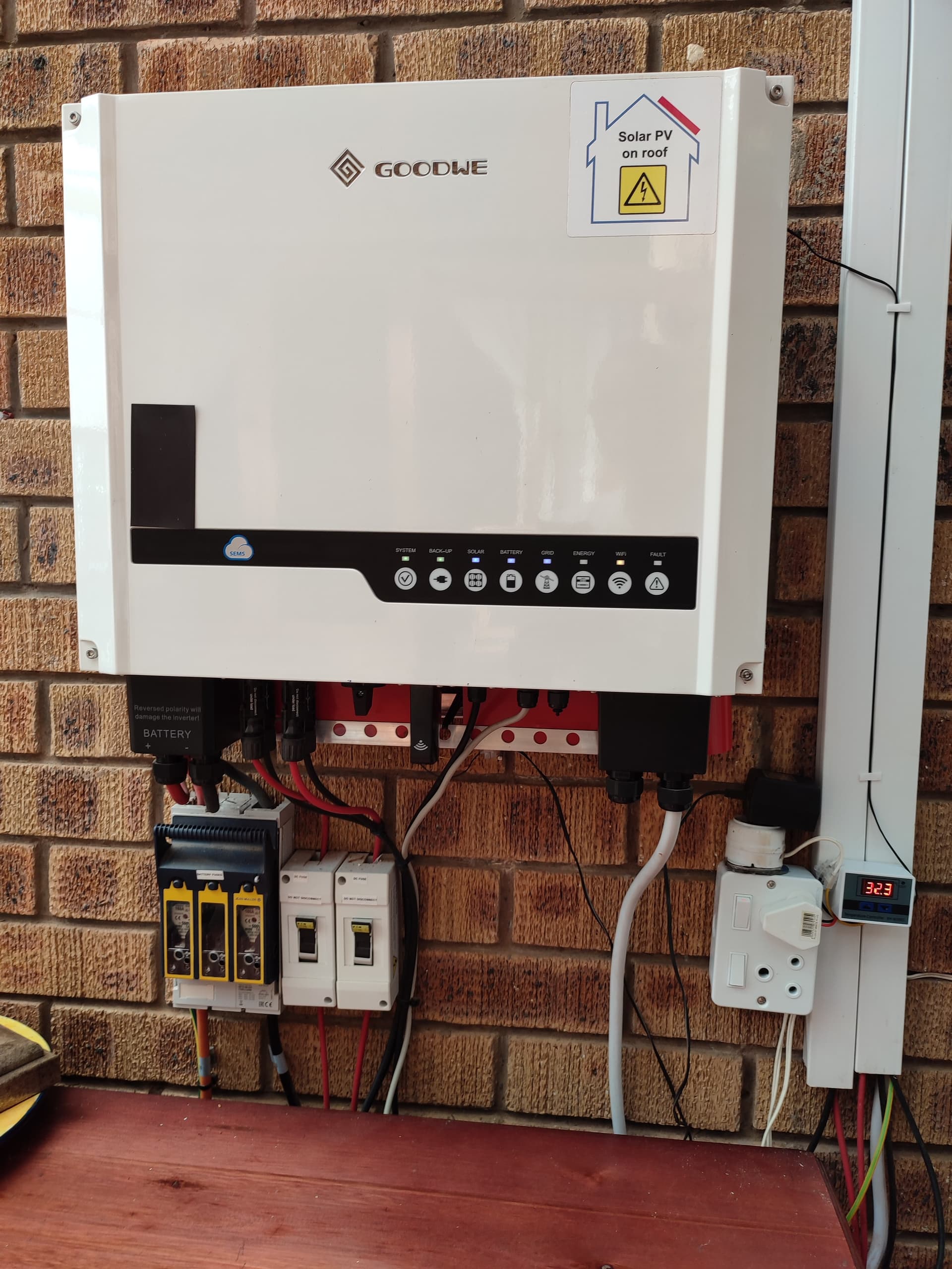

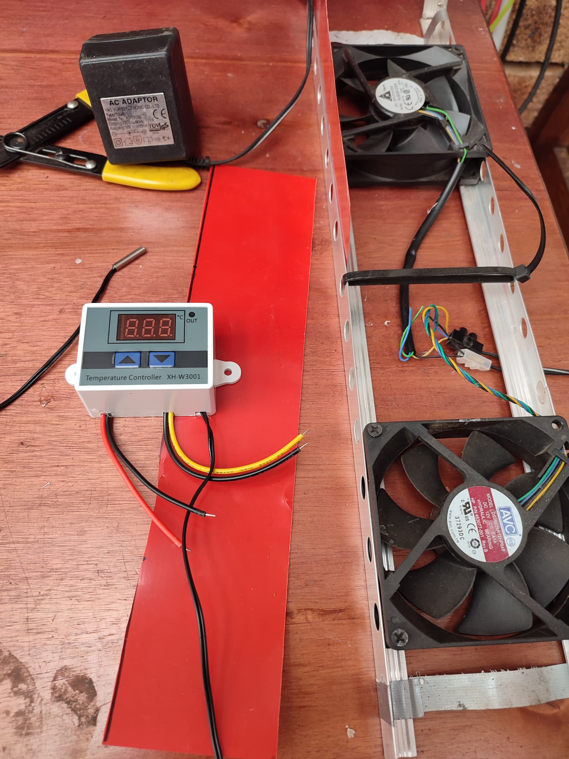

Have you considered a low tech solution using a [Digital Temperature Controller with LCD Display XH-W3001] that activates a fan if the temp reaches a certain threshold? I’ve been using a couple of computer cooling fans to keep my Goodwe temp below 45 degrees, it turns off at 35 degrees. Been using it for over a year and it works well. I could post a couple pics if there is interest in the approach.
Yes please.
Used 2 fans from and old PC, and a 12V charger that I had lying around. The fans fit nicely about 8 cm below the inverter. I salvaged aluminium angle used by tilers, initially taped and cable tied the angles together, but later attached to the fans with screws. Plastic file divider (red) used to channel the airflow. Money was spent on a [Digital Temperature Controller with LCD Display XH-W3001] Takealot or Temu (12v output model, you also get 220v models) R229 and a R40 plugbox for power. The temp sensor was located at the back of the inverter at the top of the heat sink. So far working well although a bit noisy, I believe one can buy quieter fans, but in my case the Goodwe inverter generates maximum heat midday so noise not an issue. A couple of pictures of the components used and installation.
That’s very neat. I happen to have 2 computer fans as well. I think I might try this.
