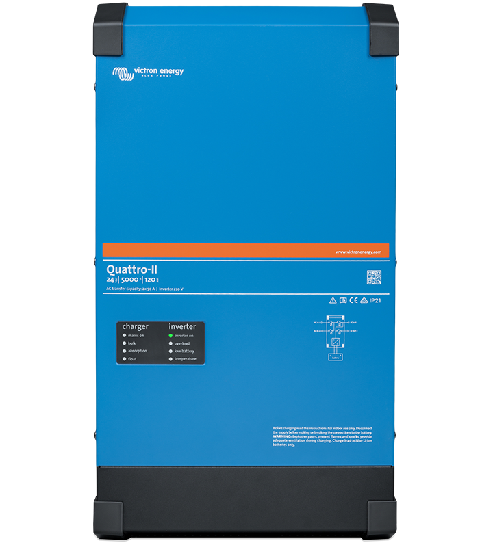

I see the new ad for the Quattro II.
How is this different to the MPII? Looks very similar. Is the MP on the way out…![]()
Multis have one input. Quattros have two inputs. So one input could be grid and the other a generator. Therefore, no manual changeover switch needed.
In the same way the original Quattro is different from the original Multi: It has two AC inputs (and two outputs, hence the name, 4 legs).
The Multi is NRS approved while the Quattro is not - last time I checked.
I didn’t know it’s full name is “Quattro gambe” ![]()
