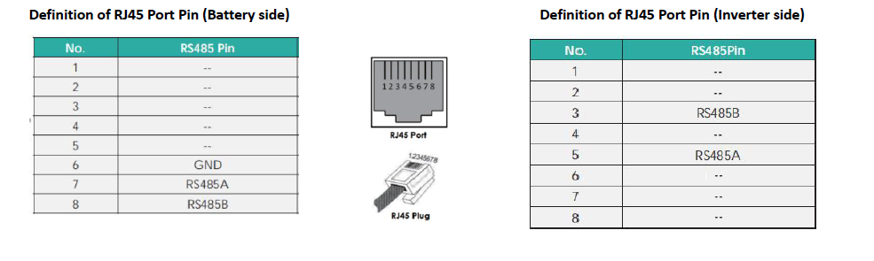

Hi guys i have a probleM and need help. I have a Kodak VMIII connected to two Pylontech UP5000 batteries. The second battery goes into alarm state every night at around 4am. The setup of the inverter and batteries worked fine for about 3 weeks with no alarms or issues then this started. I HAVE TRIED SOLVING THE PROBLEM BY CHANGING THE BATTERIES AROUNS AND MAKING THE SECOND BATTERY THE MASTER BUT IT STILL DOES THE SAME.
