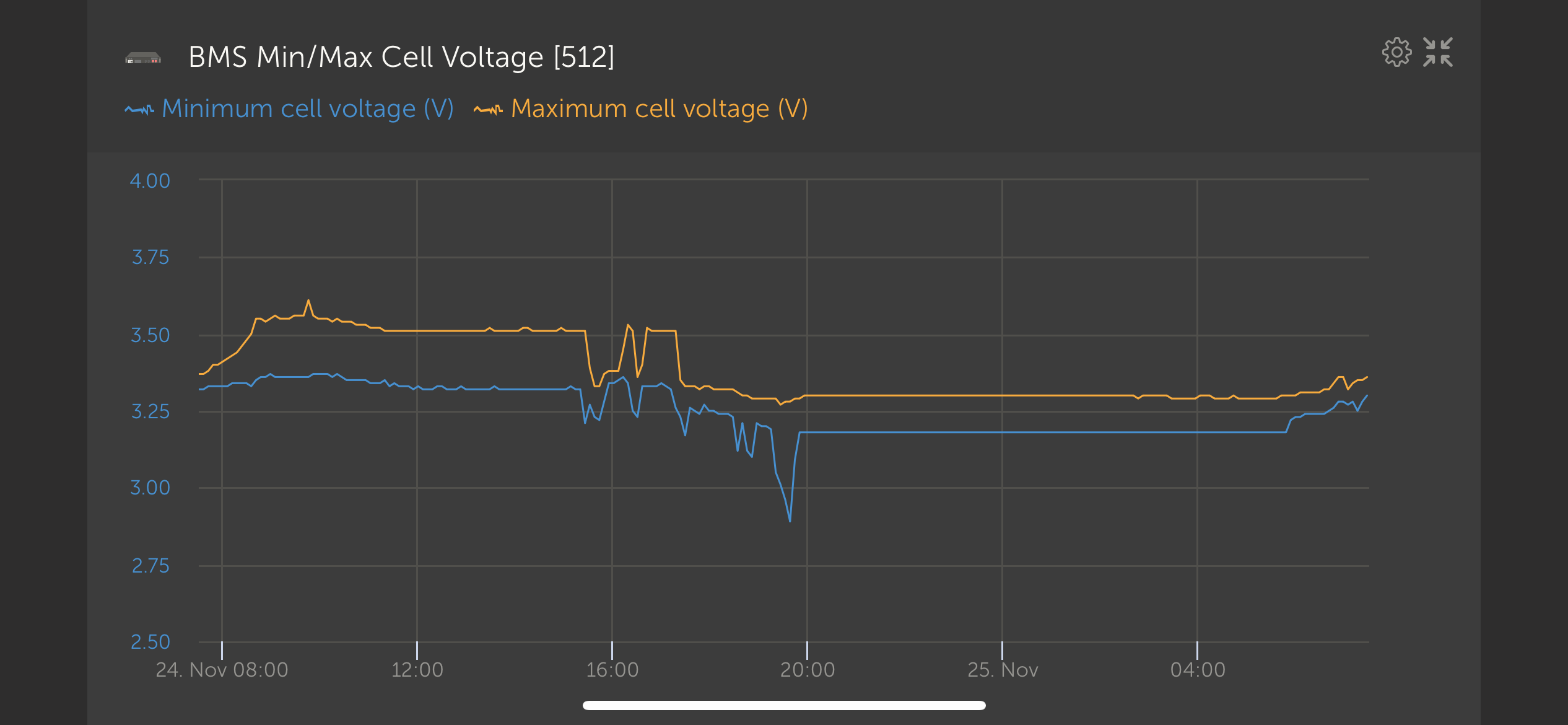

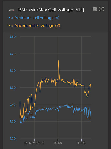

I would like to see that lower voltage pull up to above 3.4V in the next week or two. Keep an eye on it. The higher end also seems to be tapering down a bit, which is good.
This “algorithm” is really bleedingly simple. The BMS itself could do something similar, and better, since it has direct access to the data… not like me who gets an update once a second or so.
I wish you could do that same for the BMS in the Etowers. Mine spiked to 3.9v the other day.

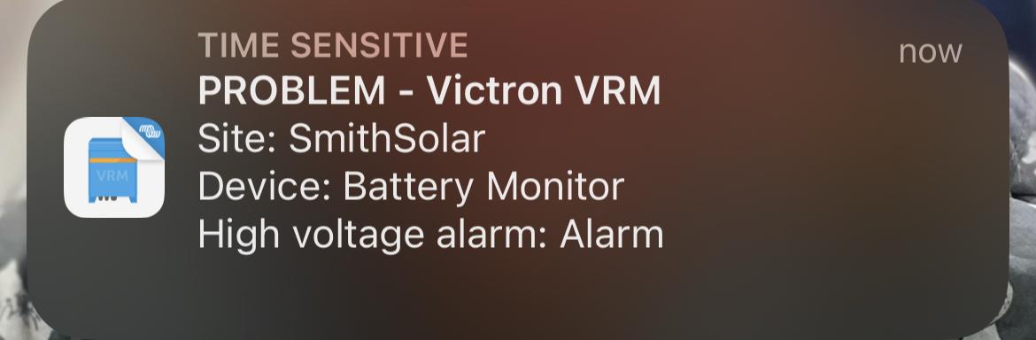

Spoke too soon, got an alarm today (first one since the update).
The “low side” is peaking above 3.4 now @plonkster
Well, the algorithm still uses a very slow filter to keep the charge voltage stable, so if a high cell voltage develops suddenly it will not respond fast enough. I’m alright with that. If it makes the alarms less – and it seems to do so to the point of eliminating them for most people – I am okay with that.

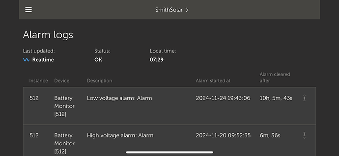

Is this progress? We’ve progressed from high voltage alarms to low voltage alarms (first time I’ve seen that)
OK, I can see that there was a low cell event just before 8PM. It is hard to say whether there is progress at this point. Having the cells close together at lower SOCs doesn’t tell you much. What we want to see is all the cells above 3.4V, and still getting closer over time. Once they reach 3.45V at the same time, you’re essentially done.
Just seen this topic thanks for all the information. I’ve got two US2000’s that I bought back in 2019 that have been throwing High Voltage errors for a few months now. Haven’t had a chance to deal with it until today when my solar charger shut down with error 38.
