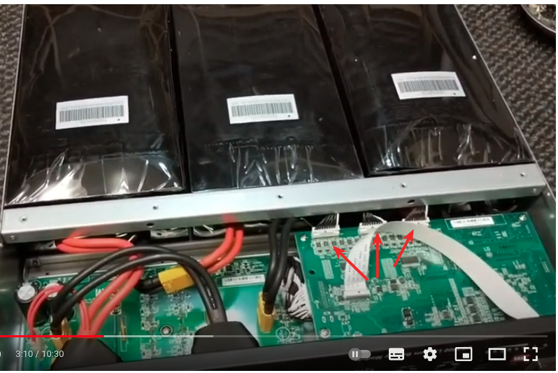

This is the video I was thinking of: PYLONTECH eBay solar storage battery teardown faulty repair BMS battery swelling 54v pack - YouTube
And the balancer board with the individual cell balancing wires are here:
You can even see the bypass resistors below, and count them… there will be 15 of them, which matches your cell count.
So carefully accessing those balance wires, you should be able to bring each cell up to 3.5V individually.
Disclaimer: I have not done this myself!
