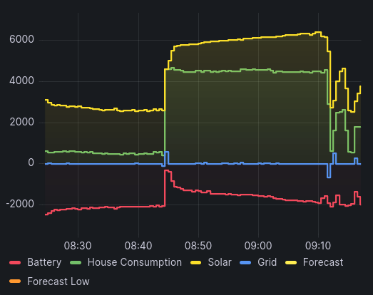

It can do 6.4kW from the PV all day long, as long as:
  • There is at least that much available from PV
  • The load profile is correct.
In terms of the load profile, it can only do 100A or 4.6kW to the battery (whichever is lower). And also only 20A or 4.6kW to AC. So in order to take 6.4kW from the panels, you have to have a mix of AC load and battery load (ie battery must not be fully charged). If the AC load exceeds 4.6kW (essential+non-essential), the PV total will be limited to 4.6kW (ie no charging the battery).

Well, you can still only output 20A on the AC side of the inverter. But if you start using the oven and stove, or the geyser switches on and you have other normal loads, you can quickly get past 6kW.
In a sane world, you could have a base load of 600W, export 4kW and charge the battery at 1800W with this inverter. It is really designed for a market where export is the norm.
