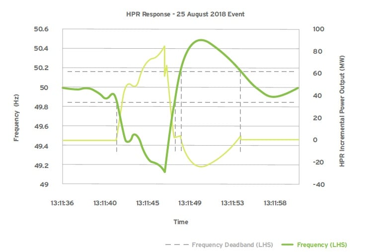

RE types have negligible system inertia, whereas big spinning machines can stabilize frequency events.
I think there will be a future demand for grid-based synchronous condensers to provide that system inertia.
Or some of these to stabilize the grid frequency.
