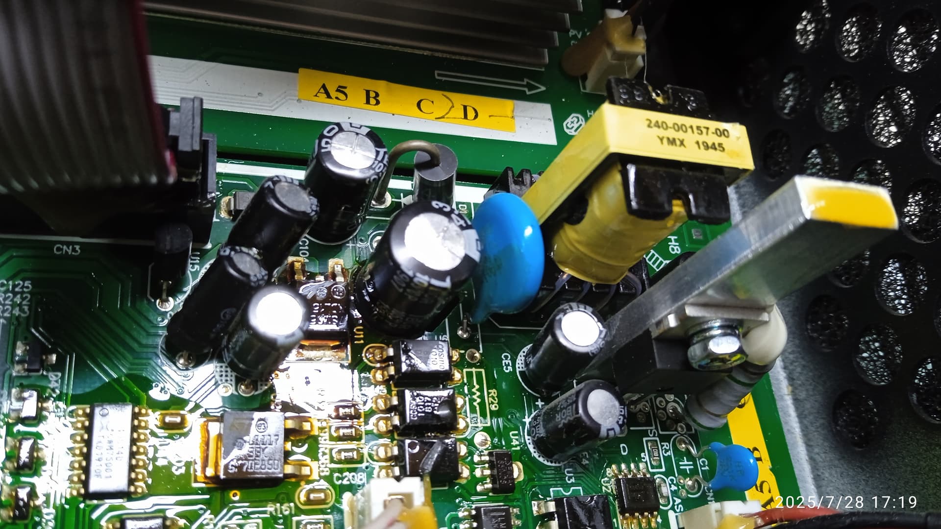

Came home last week and my 2019 Must 3kw inverter was off. opened up the case and spotted a popped a cap and maybe a few other componants. I suspect it was from the 24vdc x 150a LiFepo4, as I have been battling with inverter settings to get the inverter to charge this battery, but to no avail.

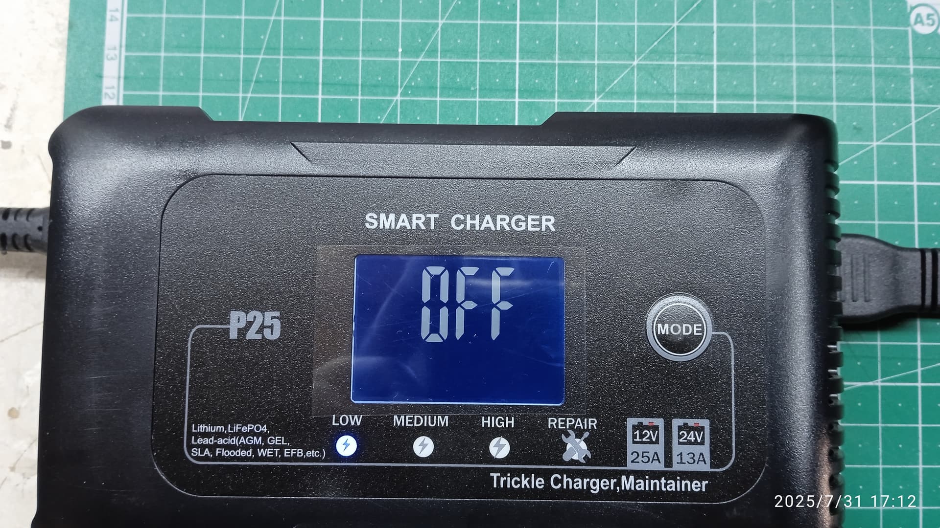

to save the battery I bought a 24vdc smart charger to keep the battery topped up however even this smart charger would not charge the LiFepo4?

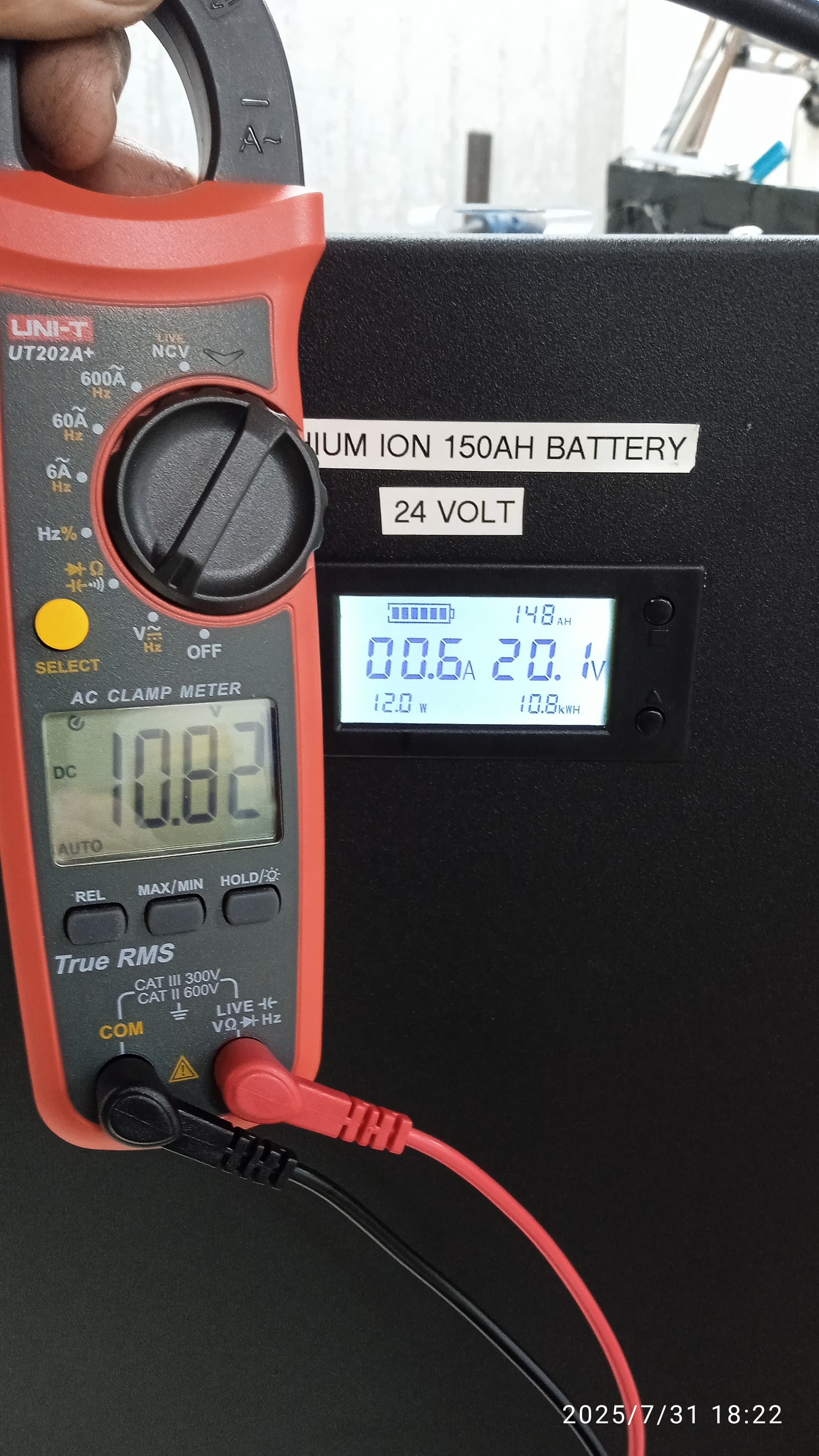

smart charger identifies & chargers both my 12vdc agm batteries, but doesn’t even see the LiFepo4 battery? when I measure the battery voltage with my meter it says -+10.82vdc - YET the battery voltage display says 20.1vdc?

That battery LCD screen is a separate component that is very unlikely to interact with the BMS in any way. It is probably connected directly to the cells displaying the voltage over the cells. The multimeter is connected to the external battery terminals but at least one battery external terminal (and therefore also the multimeter ) is connected “through” the BMS.
If the battery LCD voltage is correct, that would suggest a voltage of around 2.5V per cell which might cause a BMS to disconnect to protect the battery and enter a “sleep mode” - your external charger does not look like it has a “wake up” function. It is also possible that the BMS is defective.

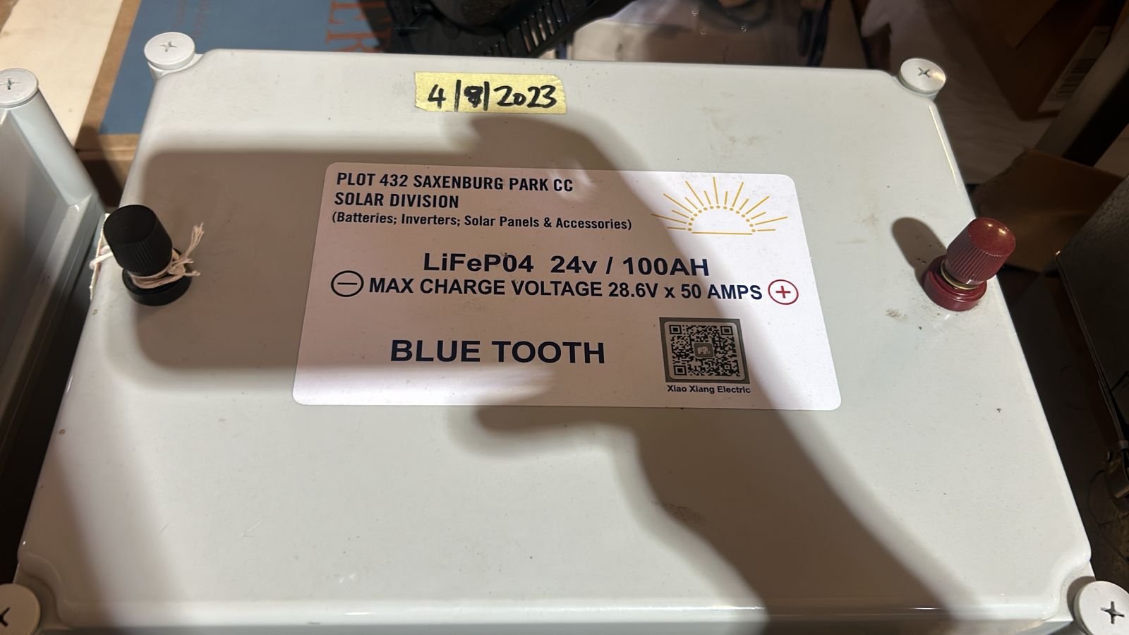

Btw, if the label on the battery is taken at face value it implies that the battery is not LiFePO4 which will have implications for charge voltages etc.

ok makes sense why the smart charger - which auto detects battery type, won’t charge now cause the battery is in sleep mode.
anyway to get the battery out is “sleep mode”?
IF you are lucky the battery is only in sleep mode (the previous charging issues suggest it is likely worse).
at your own risk…
a current limited DC 24V source (bench power supply) momentarily connected to the battery is one way. A “dumb” 24V battery charger might also work (use the lowest possible charge current if selectable). If feeling adventurous two series connected 12V batteries might do the trick.
BUT I would take/send the battery back to the supplier since it does not appear to have ever worked correctly.
