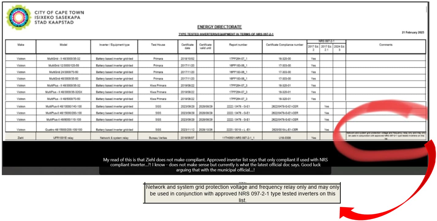

Thankfully the Ziehl UFR1001e is already on the list.
If you mean that fitting of a Ziehl makes the older non NRS compliant Victron units compliant then not quite how I read it…? I’d love to be wrong though…
“may only be used in conjunction with approved inverters…” And then…

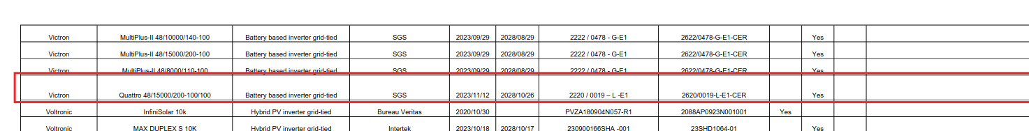

Yes, I saw! Was wondering if typo…?! Does that mean approvals for others (5kVA/8kVA/10kVA MP’s & Quattro’s) on their way?
It’s weird that they aren’t already on the list. The internals of the inverters are mostly identical, the difference between models is pretty much just more/bigger of the same (MOSFETs, Transformers, etc). You don’t send one of each model for testing. You send a representative of the series. If the 15kVA is there, it means the others should be too.
A few things come to mind in this regard…
  1. Local dopamine release in anticipation of other Victron units to follow as “Approved”…
  2. Your statement “internals of the inverters are mostly identical, the difference between models is pretty much just more/bigger of the same” true for within each of Quattro and Multiplus ranges and therefor listing of other Quattro models might be imminent but not necessarily Multiplus units…?
  3. Since the “Comments” field on the far right for the Quattro is empty, does this imply that “approved” even without the addition of the Ziehl?

By the letter of what is written, you could interpret it like that. Technically it would not be sufficient. NRS097 requires two disconnection points (one is allowed to be electronic). The Multiplus/Quattro has only one set, the Ziehl adds a second pair, plus redundant monitoring of at least the passive parameters.
