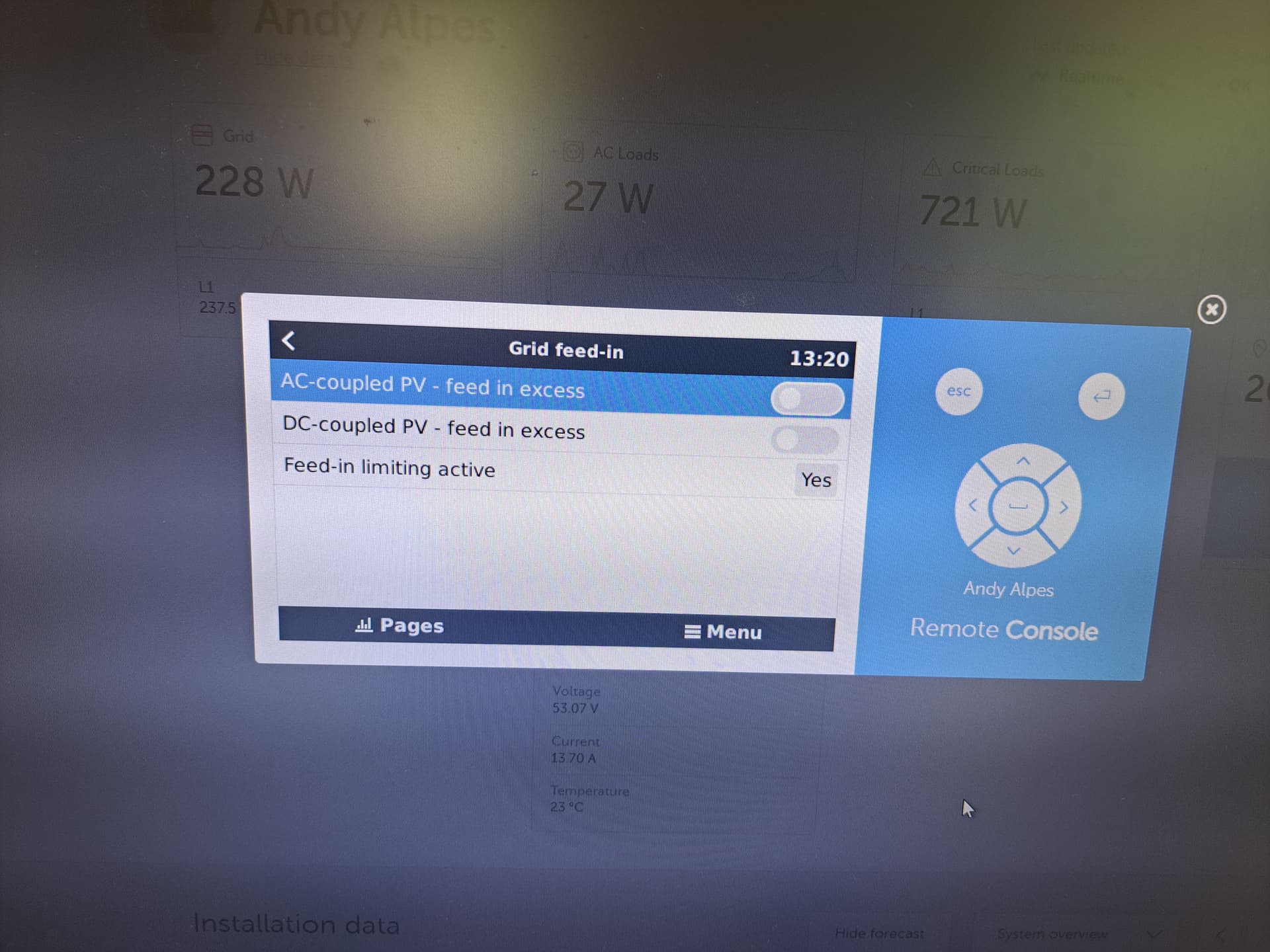

Good day All
I have recently connected the 2nd MMPT with Canadian PV panel, Notice however that my Mutilpus 2 with AC connected Fronuis 5.1 has started to back feed now. Can anyone give advice as to why and how to remedy the issue?
Check under ESS.
There is a Grid feed-in setting.
Should be off when not feeding back.
Feed in is off,
Something is limmiting the charging of the battery.

I think it could be as its in absortion mode and not bulk, or automatic software updates as all was working extremely well untill a number of days ago

No sun, cable problems so no grid for a few days and battery being below minimum SOC for days send the system into a slow charge mode. Trying to pull him out now.
