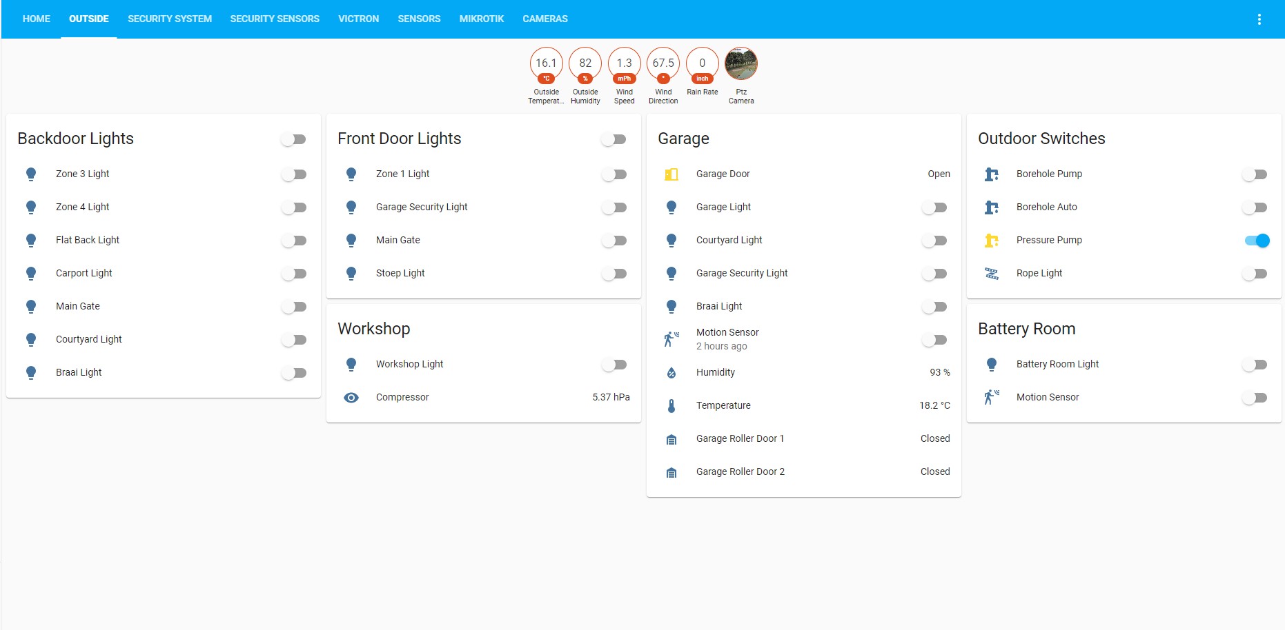

My system is now about 4 years old and from the beginning I was running Openhab , mainly because that was what the first EmonPi had installed default and later because it has a free reverse proxy that you can use.
As my system grew maintenance is slowly becoming a problem is I decided to move away from Openhab and setup a pure Node red system. (100 % of all my rules and automation lives there). The ui works ok but is quite basic in comparison. So I decided to give Hassio a go for a bit of “bling” and I must say after I got the hang of yaml it is quite good. All my stuff is MQTT so I dont need to all the plugins but even the MQTT auto detect works like a charm once you under stand the template.
I have even set up some of my custom Arduino’s to be detected in Hassio.
There is still some work that I need to do but this is what I have sofar.
I have quite old cameras so I am waiting for the New ptz cameras that will have much better image quality.
I have also found a service called Zerotier One that you can use to link your home via vpn with out the need for port forward. It is running on a little Pi zero and so far so good.
I started using Tileboard a while ago, because I needed something that just loads without requiring a login first (although it uses a long-lived token, which has security implications of its own). In the hair salon next door I have an Rpi hooked into this showing the customers some interesting stats (aka advertising) as well as the weather and a snapshot of the security camera so that they know their vehicles are fine.
I’ve bought some cheap Teclast tablets on Banggood a while ago that I plonked on the walls in the house. They Android 9 so still enough to display lovelace on. I then set the panels to only display in a sort of kiosk mode (much easier to do with the latest versions of HA out of the box)
You don’t see the navigation icons and status on the tablet, they only showed up when I tried to do a screenshot.
Nowadays , tablets are quite cheap. A very nice app to use on Android is Wallpanel and the html page for Hass.
Auto start on startup full screen and then there quite a couple of “nice” features.
TTS via mqtt - I use this to announce when the main gate opens and closes or alarm zones been triggered.
You can even get access to the front facing camera via http - best of all its for free
I used a “Webpage Card Configuration” and the tab set to Panel mode (This renders the first card at full width) If if you are in a phone you should get full screen.
It is a Mikrotik integration via HACS fun to look at but as I already control the router via node red it is more bling than anything else.
To switch on the lights at night (and off when nobody is in the room) and the alarm system if activated.
As we are on a farm I have a fair amount of out buildings so I also monitor the door status and get notified if we have left one of the doors open. after 18h00.
The house will also be set to “Away mode” if none of the Pir sensors gets triggered for 4 hours , this will switch the house lights randomly on and off between 17hoo and 21hoo to simulate presence. Most of the time I don’t forget to activate it but if I do it comes on by it self.
