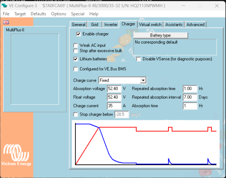

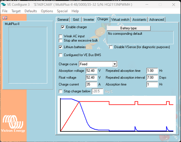

If you use Victron connect from your PC and link it to your VRM profile, you can set up the MPPT to run in Standalone mode. With your MPPT being a smart version, you can use Victron connect on your phone and follow the instructions in the link below. You need to make sure that the charge voltages don’t exceed the battery max charge voltage. You can also ensure that your config file on the Multi is configured correctly through your normal VRM.
Config File: ensure that your charge voltages dont exeed the max allowed charge voltage of your battery.

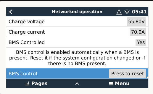

After doing that, I would unplug the Can cable on the battery, that might cause a error 67 (If I remember correctly) complaining about the missing BMS, I will then “Reset” BMS control on the Remote console - Device List - Your MPPT - Networked Operation
Networked
You can now unplug the Ve-Direct from the MPPT and the MK3 from the inverter and switch off the Pi. The system should run as a standalone system with each component on its own till your done with the PI. This will also safeguard your system in the future should your pi fail.

As far as I remember when setting up the system initially I configured separately the multi and the SmartSolar so they can run safely with my battery, however will check this to be sure.
