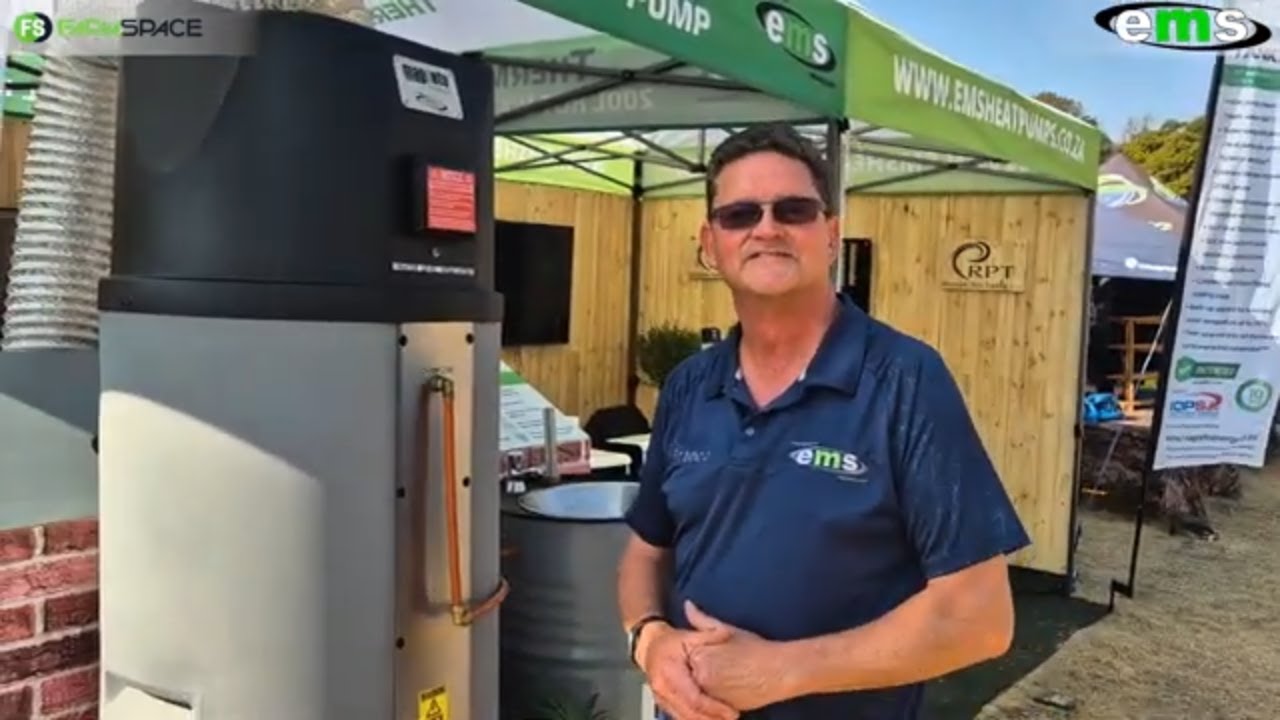

Magneto Thermotank heat exchange geyser
This product popped up on my Youtube feed this morning.
It looks quite interesting, however for the price of R30k (quick Google), you can basically buy a traditional heat pump and traditional geyser, to end up with much the same.
Also it doesn’t state for how long it consumes 750W, how long it takes to heat the 200l of glycol / water to 60 degrees.
This looks very interesting.
Your thoughts on this?
