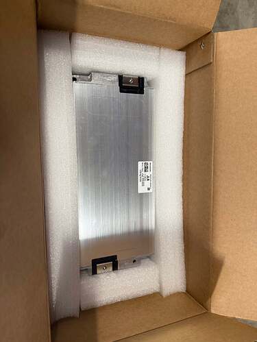

I have a friend that got himself 2 lithium Ion cells that seemingly comes from a Jaguar BEV.
I cant find any charging specs for these units on the net (but I know my searching skills suck)

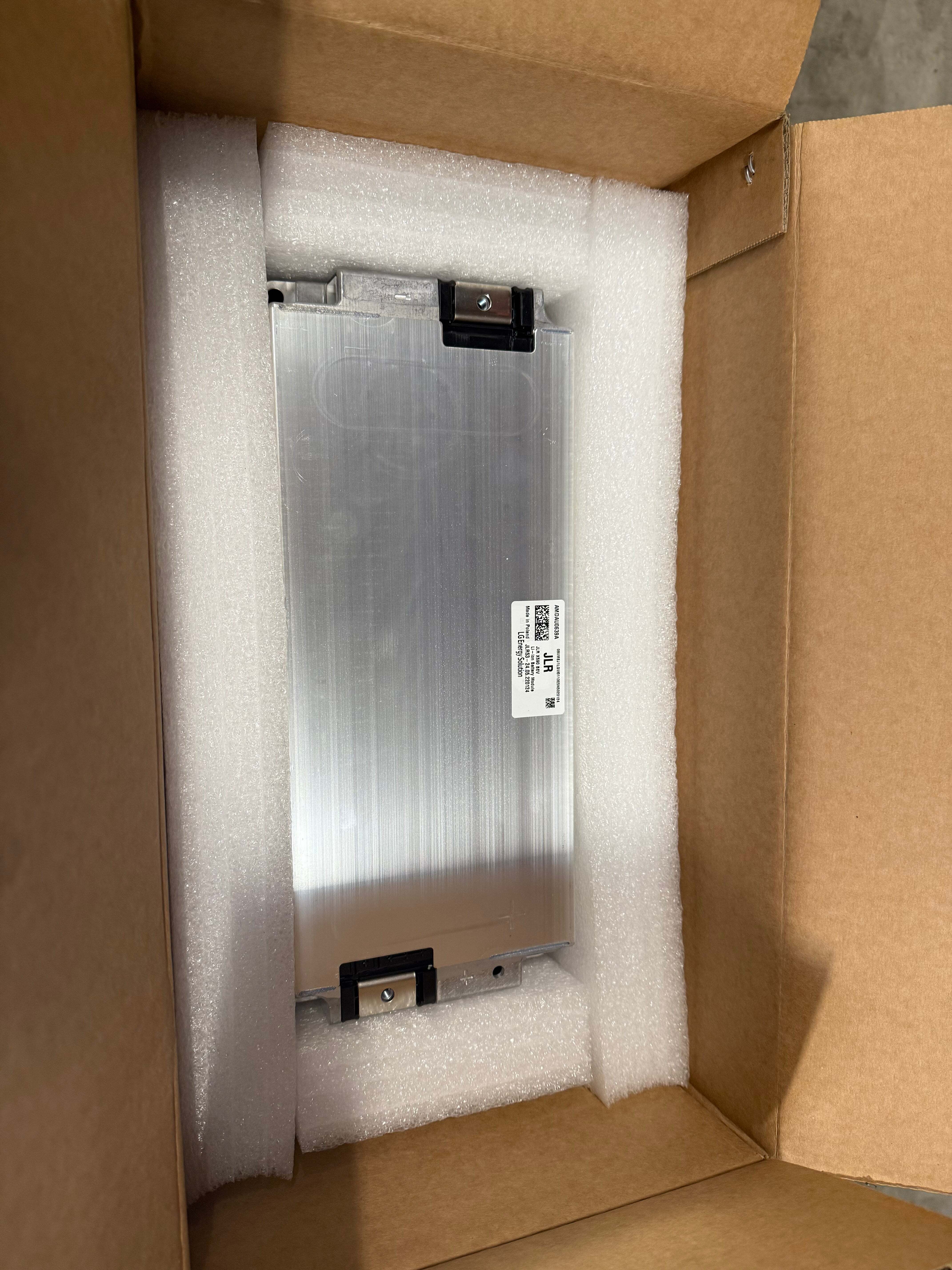

11v battery, less than I thought.
Jaguar I-Pace 2.6kWh, 11V, 236AH Battery module (Used).

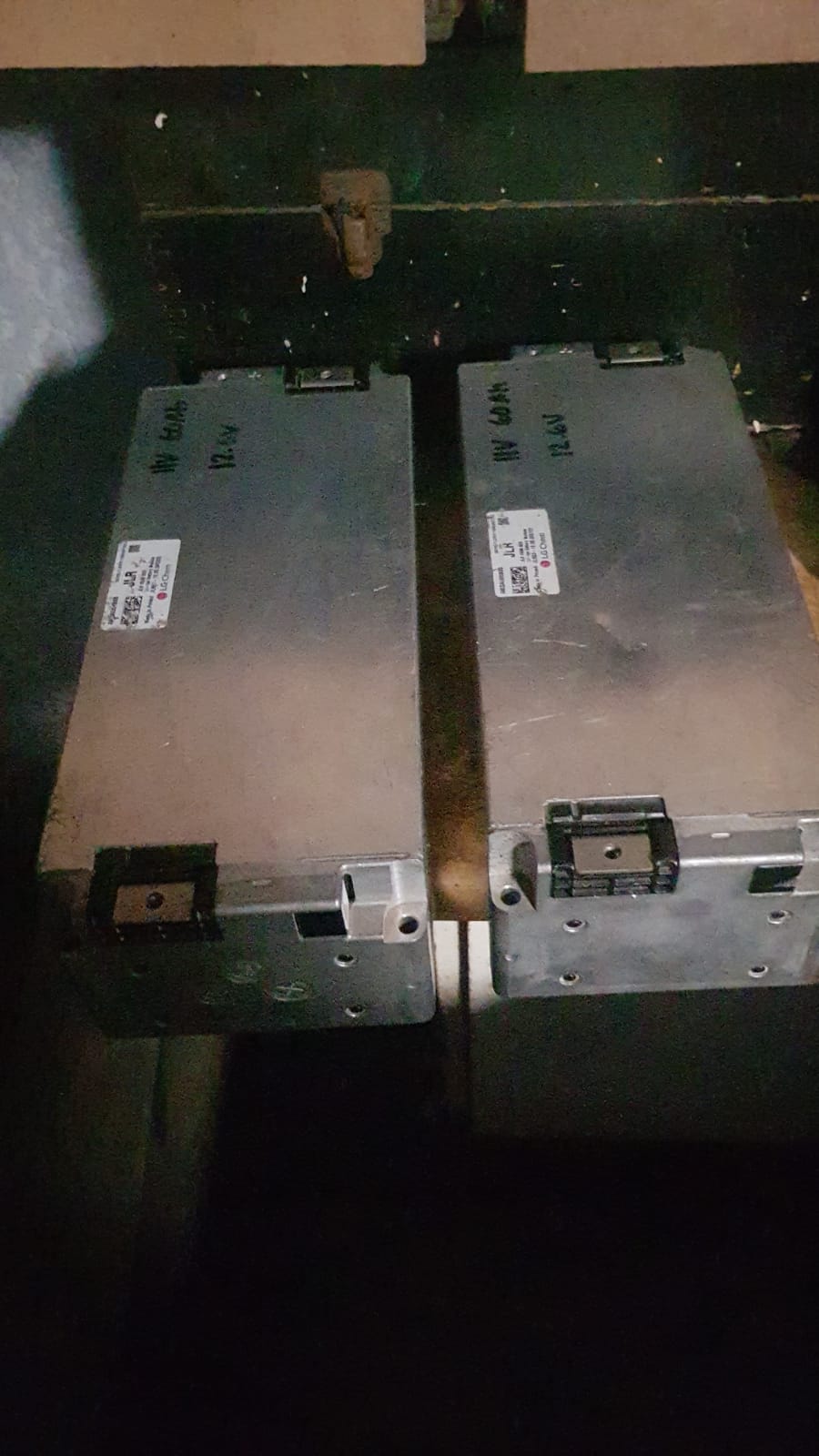

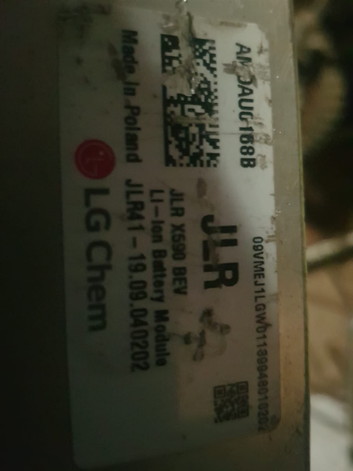

Well, it says JLR on the box, and it is made by LG Chem. Looks right too. It is probably more accurate to say they are Lithium Ion modules rather than cells, otherwise they would measure a mere 4V or so.
They are apparently 4P3S, so around 11.5V nominal. Not great if you wanted a 12V drop-in. Max charge voltage would be no more than 12.6V (4.2V per cell), and if there is any imbalance, that would already be looking for trouble.
It’s definitely not an ideal 12V replacement.
Also, don’t show him this.
Lithium Ion with a 3.6V nominal voltage usually have a max of 4.1V per cell (12.3V per pack). You definitely want to use a programmable CC/CV charger with CV set to 12.3V.
Also, these modules usually require an external BMS, which would be highly recommended with Lithium Ion chemistries.
