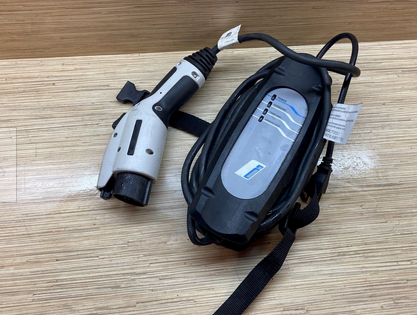

First, with the default cable that comes with the car, you have three options: Low, Reduced, and Max.
Low is about 1.5kW. Reduced is about 2kW. And Max is whatever the EVSE allows, which for the “granny cable” is about 3kW. This is the cable, not the exact one, snagged that one off the interwebz:
Selection_427
The three settings already allows for some day-time charging from the backup side of things, and once I finally upgrade to the larger inverter things also change somewhat. May not need much more than the “Low” setting.
As Justin also mentioned, the EVSE uses a square wave with a mark/space ratio that tells the car how much it is allowed to charge at. That little box in the cable is essentially a square wave generator set to 3kW. And it also checks your TN bonding before allowing charge.
Smart EVSEs can vary this charge limit according to external inputs, for example, surplus PV can be sent to the car. The Victron EVSE integrates tightly with a Victron system and allows you to do that.
