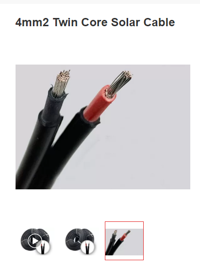

This seems a hugely logical product to have available but it doesn’t seem to be available in SA.
Makes managing cable runs and strings so much easier. Any suppliers around who have or can source?

My container has docked two days ago. will have in stock before end of next week. @TheTerribleTriplet , the extra cost is very small. The cabe we bring in is TUV certified and has a proper AC and DC current carrying capacity. I am excited about this product.
Will install much quicker than a bunch of loose wires. On bigger projects it will will be much cleaner and make fault-finding a lot easier. Cant wait for this.

Very keen to see price per meter. 4mm and 6mm ![]()
Will post as soon as I have the final Clearance Cost.
