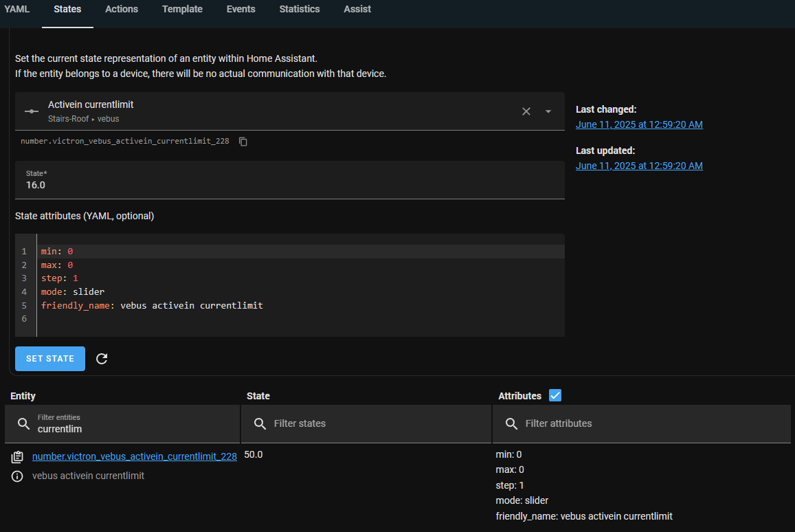

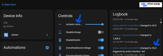

I’ve been doing that through the VRM app (phone/desktop) but when I check Home Assistant, I can find the setting that shows the value but I can’t change it even though it’s a slider…
Is this a Victron Home Assistant limitation or a MQTT system limitation or something else I am missing?

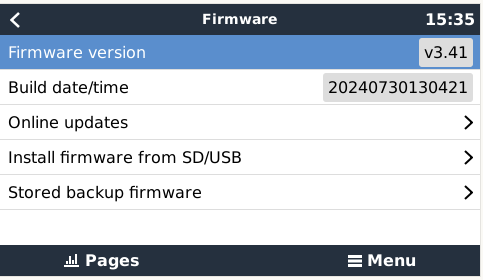

My versions

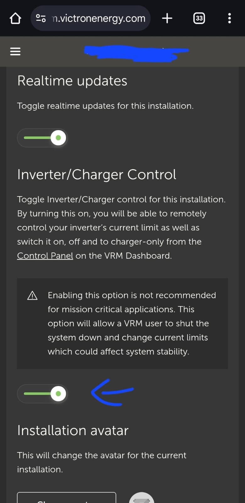

I also got this enabled already

I went in Dev → States and searched for Current limit and saw this (below) for the current integration.
Not sure why it’s got min and max to 0
When I try to ‘set state’ it changed the number in HA but then after like 20 seconds reverts back. I don’t think it actually changed anything (on VRM it did not)

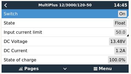

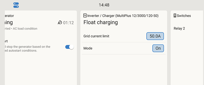

If you go from the Device List (the first screen you get, the one with Settings at the bottom), there should be an entry on it for your Multiplus. If you follow that you will get (example from the test bench):
Note the third line from the top. You can set it there.

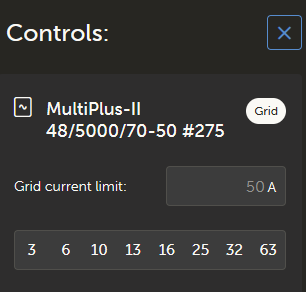

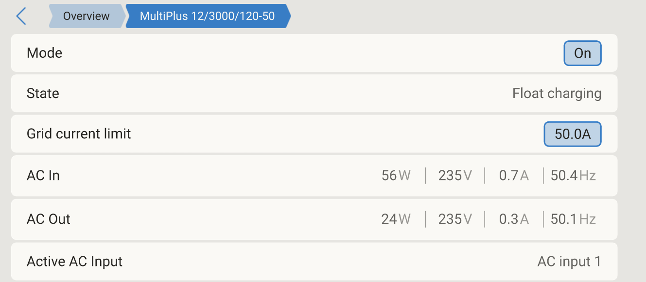

On GUI-v2, you get something similar by tapping on the Inverter block, while in the Overview screen:
Or by tapping the icon top left, you’ll get the “cards”, one of which also allows setting the current limit:

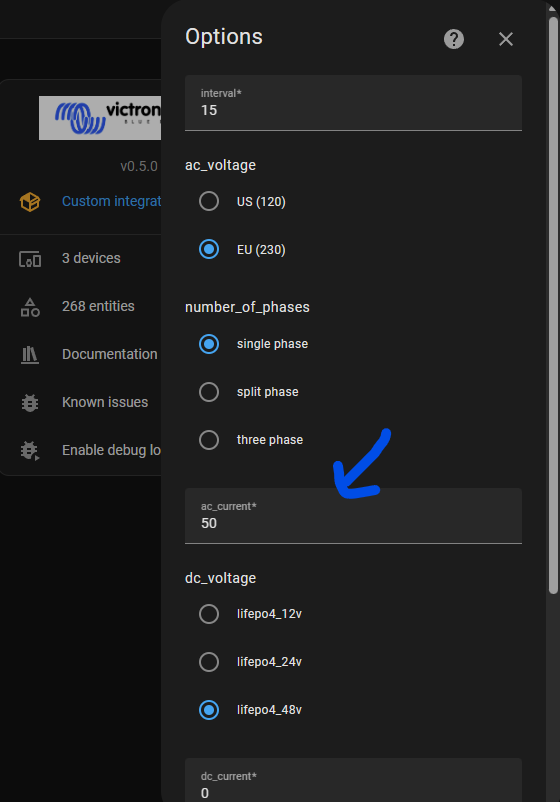

The issue I had was that in the initial integration config I had not set a maximum AC value… I decided to randomly input that and now I can use the slider to change currentlimit … I’ve been trying for so long haha.
